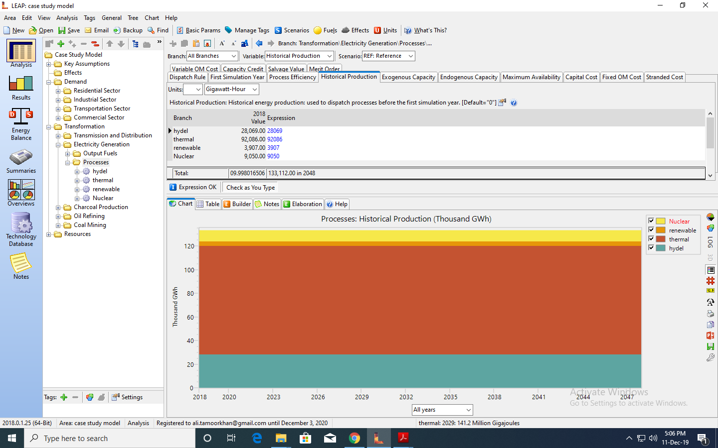

    as you can see in the tab of historical data. the data i have given 133,112 gwh is basically the current year data. but it sums up above processes and say this sum will be in 2048. while this is of 2018. i have put up the processes and value in GWh in historical production and in exogenous capacity in MW but as my previous question the value is decreasing and then increasing in the results. please guide in ma stuck at my research work due to this error.

    here, you have entered the data in reference scenario as well. that is why they remain constant.
    delete the data and only provide maximum availability parameter. this should solve your problem.
