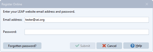

Register Online
Once you have applied for and been granted a LEAP license, go to the Help: Register Online screen in LEAP and enter the same user name (email address) and password that you use to login to the LEAP website. If you have an active valid license, this will fully enable your copy of LEAP. If you have forgotten your password for the LEAP website, you can request a new password. If you do not have an active valid license, LEAP will invite you to visit the LEAP website to apply for one.

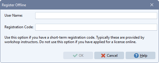

Register Offline
If you are attending a short-term LEAP workshop, your instructor may provide you with a special offline user name and registration code. You can enter these via the Help: Register Offline menu option. These codes do NOT require that you to first register as a member of the LEAP website but they typically only work for a few weeks. Do NOT use Register Offline if you already have applied for and been granted a LEAP license. Instead, use Register Online.
