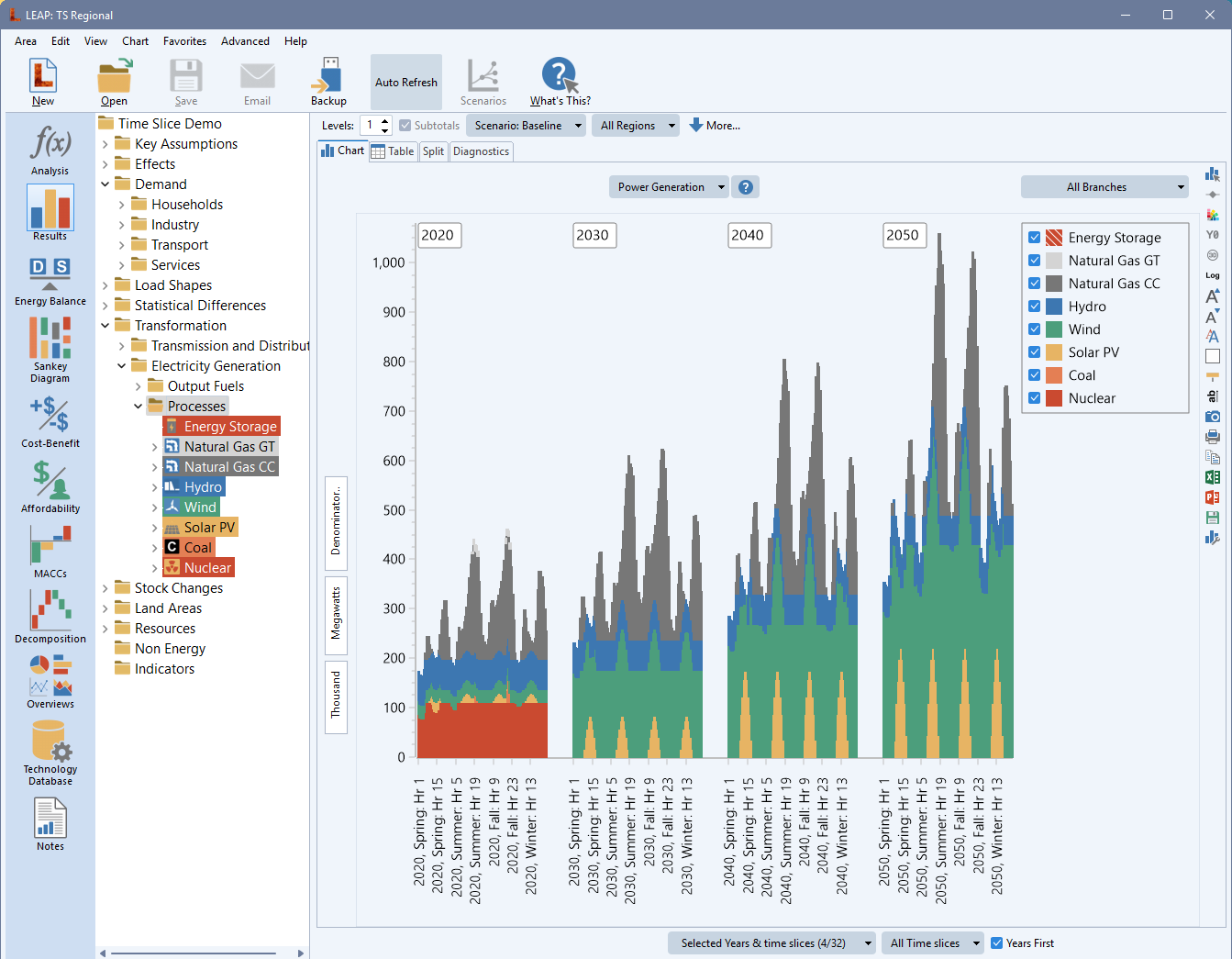

Composite Dimensions
Two dimensions of a result can be combined on the X axis of charts, making it possible to create a greater range of chart types. These "composite dimension" charts are particularly useful for making multiple side-by-side charts all sharing the same Y axis. For example, you can create charts that compare results across selected years, scenarios or regions. The list of composite dimensions available depends on the type of results being plotted and includes Scenarios & Time Slices, Scenarios & Branches, Scenarios & Fuels, Scenarios & Regions, Years & Time Slices, Years & Scenarios, Years & Branches, Year & Regions, Years & Fuels, Years & Effects, and Regions & Time Slices.
Composite dimensions can be selected via the button below the X axis in Results View. Look for the sub menu option labeled "Composite Dimensions" for options. Once a composite dimension is selected, an additional button will appear below the X axis from which you can choose all or selected elements of the second dimension. A checkbox next to that lets you select the order in which the dimensions are plotted. For example, when selecting Years & Scenarios, you can plot separate charts for each scenario with each chart showing years, or you can plot one chart for each year comparing values across scenarios. You can also choose to display all or selected items for each dimension.
When working with time slices, buttons in the "selected" dialog let you filter time slices to show the slices for a particular season, day type, or time of day, with the choices depending on how you have configured your time slices. Similarly, when working with fuels you can quickly select fuels from a particular fuel group (e.g. all oil products).
An example of a chart with composite dimensions is shown below, with results for time-sliced power production animated by year including the energy consumed or produced in different time slices by storage technologies.
When showing composite dimensions on a chart X axis, you can choose various options for formatting X axis labels. By default, the names of the items in the first dimension are shown as labels across the top of the chart (as shown above), with the items from the second dimension shown as the chart's X axis labels. If you prefer, you can also show both the first and second dimension names entirely on the X axis separated by a colon or you can show first dimesion names on the chart and both first and second dimension names on the X axis. To adjust these options clik on the label button () in the chart toolbar, choose Labels... and then select  Composite Dimension Labels.
