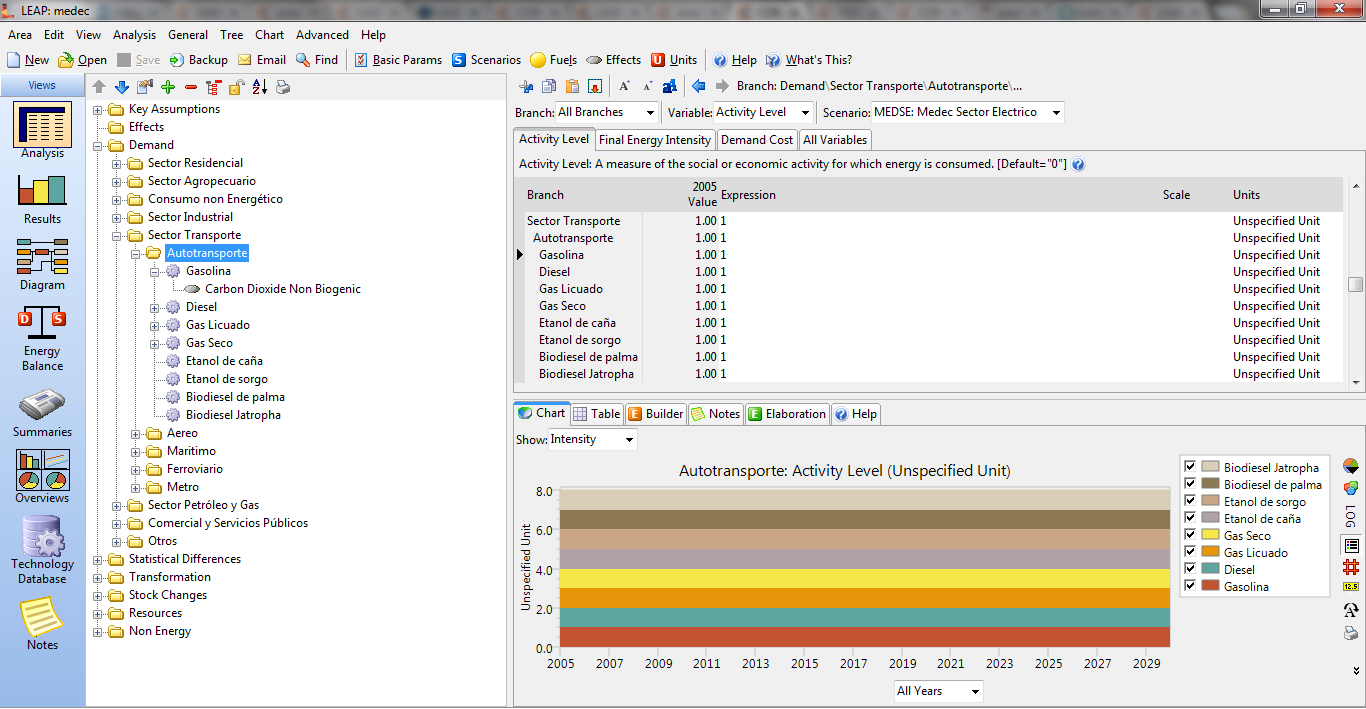

    I downloaded the MEDEC data set for Mexico but it looks to me as if there is missing data. I have attached a screenshot. For instance it does not display any numbers in the expression column (in Demand Cost tab) and has 'unspecified units'. I am fairly new to the tool so apologies if my question is basic. Many thanks in advance
    Regards
    Gaetan

    Hi Gaetan,
    The model was not built by SEI, so I cannot comment on any missing data. However, 'unspecified unit' is a valid unit in LEAP - it does not indicate that any values are missing.
