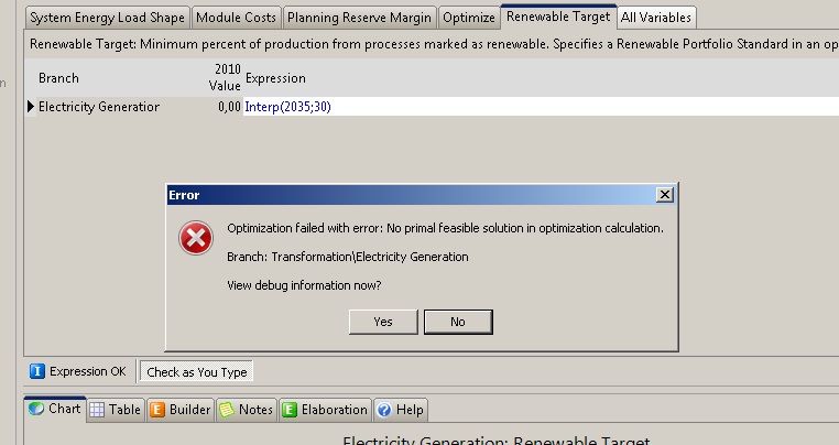

    Dear All,
    I have an error in optimization process. The notification appear as you can see in the screen capture. I do not understand and please help me how to solve the problem.
    Ahmad Suhono
  • Taylor Binnington 11/19/2014
    1587 Views
    Hi Ahmad,
    The message "No Primal Feasible Solution" indicates that OSeMOSYS was not able to reach a solution, given the constraints which you applied to your system.
    This often means that you have specified conflicting constraints. An example of a conflicting constraint may be that you are enforcing a nonzero renewable target, but have no renewable processes to build.
    Try first running your model without any additional constraints, to see if a solution can be found. You can then gradually add them back in, to give you an understanding of which ones may be conflicting with one another.
