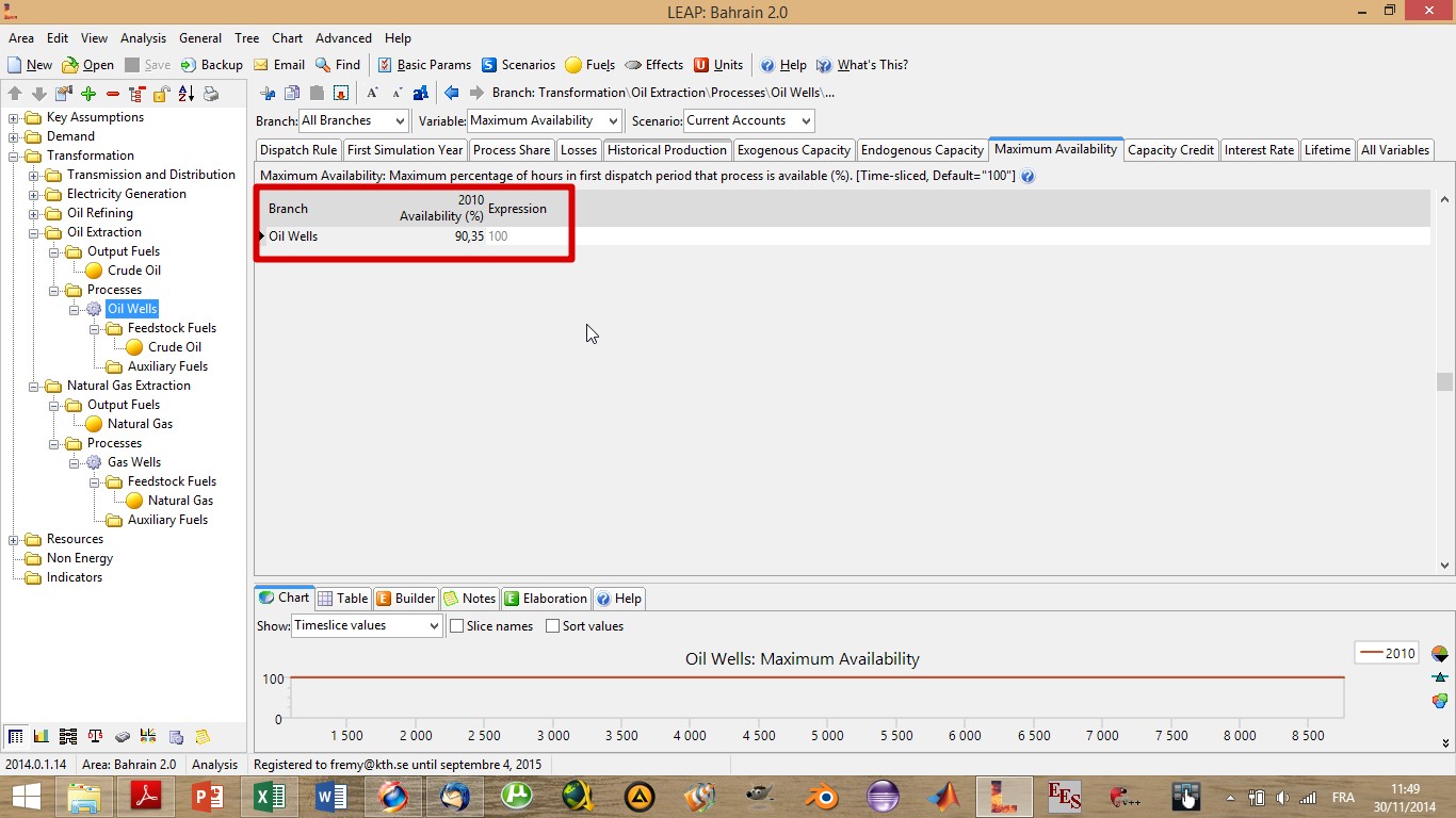

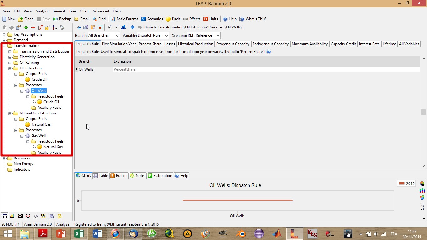

    we are a group of students working on the simulation of Bahrain energy balance. We are trying to model Bahrain natural gas and crude oil extraction. To do so we have added 2 "sub-folders" in the Transformation branch, the corresponding technologies, and insert the historical production and capacity based on 2 data sources (pic 1). That gave us maximum availabilities of about 90% for both, which seems correct (pic 2).

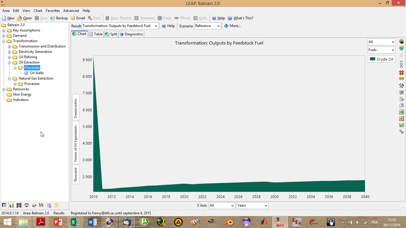

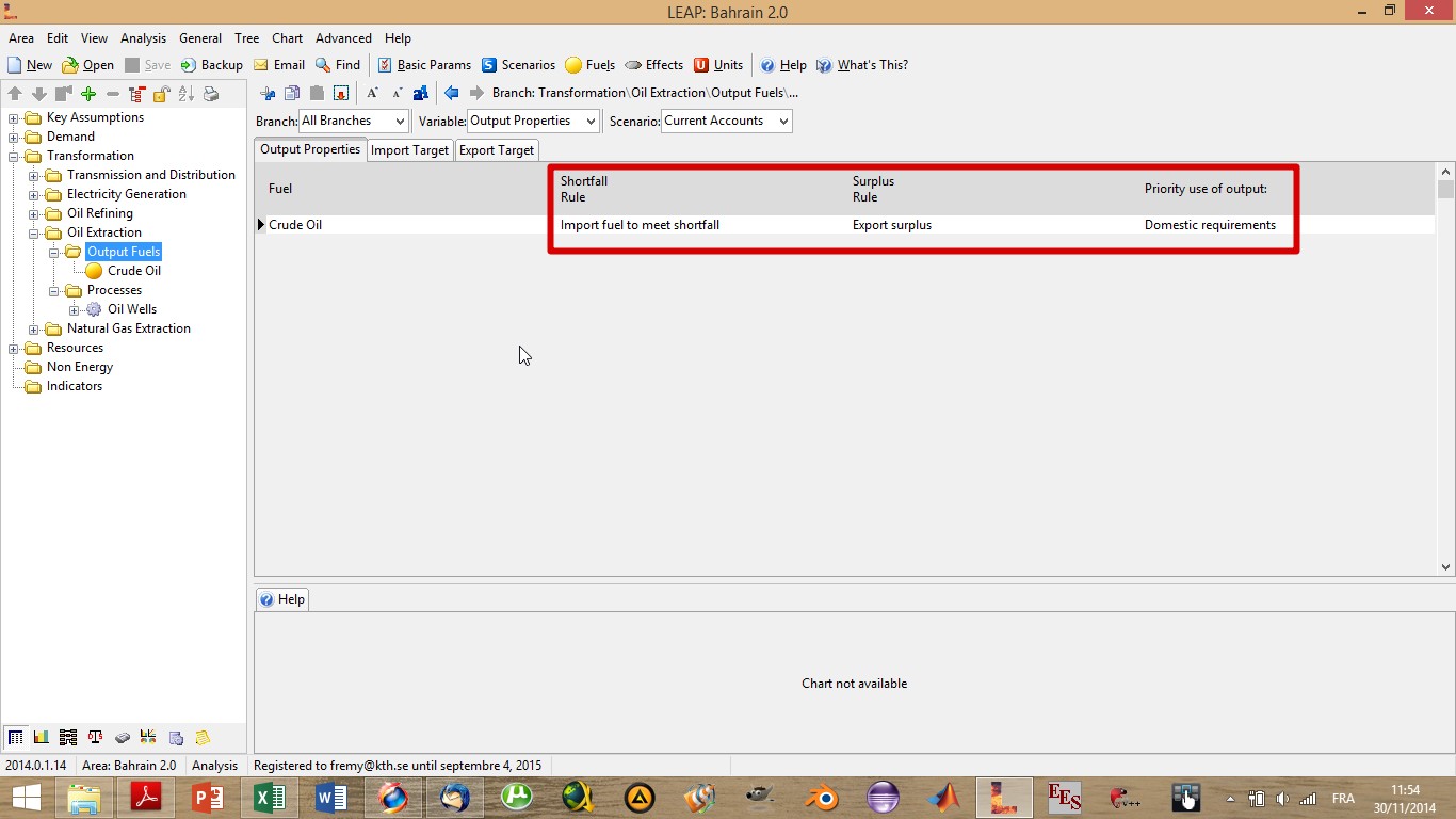

    However, when we go to the results tad, whe can see a drop in natural gas and oil production (pic 3) at year FirstScenarioYear + 1 (2011 here). Imports and exports have been set up correctly (pic 4).

    Apologies for the delay in replying. From the screenshots which you provided, I would guess that the problem comes from the Dispatch Rule which you have set for your processes. I see from "pic1.pjg" that the rule is set to 'PercentShare', which means that starting in the First Simulation Year, the process is dispatched to meet the percent share of the module's requirements which is given by the 'Process Share' variable.
