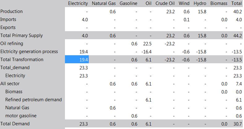

    Thanks. I have designed a plan for st johns.
    In the energy balance output the total demand shows 30.7 MWh. And production shows 40.2 MWh. But still it shows import of 4 MWh. But why would it need to import where the production is much higher than the demand.
    I am attaching the screen shot.
    I would be really grateful if you could please clear my confusion.
  • Taylor Binnington 2/18/2015
    1212 Views
    Hi Tasnova,
    You are comparing only the Total Production and Total Demand, but this does not means that one or more fuels must be imported.
