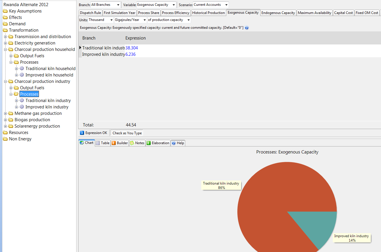

    After adding the tonnes of charcoal as a Energy Unit as you suggested....... I move to recording "exogenous capacity" to the process.....
    I find that (again) drop down energy unit choices are limited and do not include the newly added "tonnes of charcoal equivalent." I can manually convert to GJ of energy, but would prefer to use "tonnes charcoal equivalent" here also.
  • Taylor Binnington 3/9/2015
    1225 Views
    Exogenous Capacity is a measure of power, not an energy - so the option in the unit selector will display only available units of power. You'll need to create another unit of type "Power", for example "Tonnes of charcoal equivalent per year".
