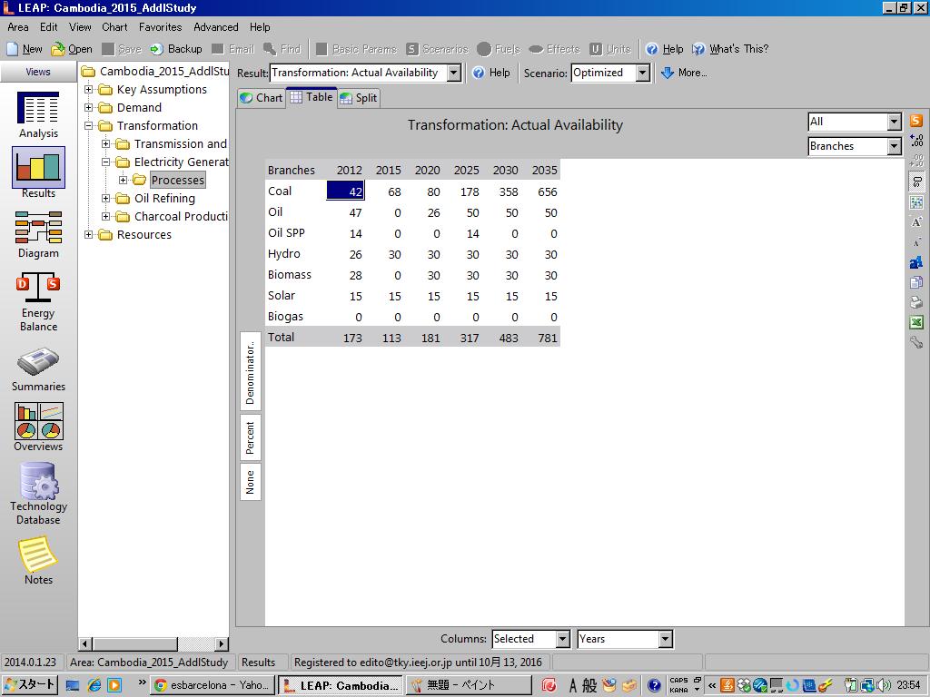

    I downloaded the latest version of LEAP (2014.0.1.23) and found a bug in actual availability.
    Please see attached screen shot. This was a result of optimizing electricity generation. The optimized scenario did not add power plants but allowed Maximum Availability to be higher than the set value.
    The non-optimized scenarios worked fine.
    Edito

    Thanks for this Edito,
    Could you (privately) email your data set to me so I can look over this issue? I will of course treat it in confidence and use only for debugging purposes. Please send as ".leap" file to leap@sei-us.org
