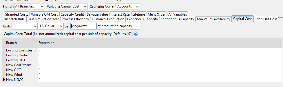

    And then I've got another question about the cost unit in exercise 4.3.5.
    In the manual, the capital cost energy unit is kw, that is $/kw. However, in my exercise, the default unit is Megawatt, that is to say the the capital cost unit is $/MW. Besides, I can't change the energy unit Megawatt, I think the unit Megawatt is inherited from the capacity so I can't change it. And the fixed OM cost is similar.

    I'l investigate the issue of not being able to change units for the costs.
    In the meantime, please make sure that whichever value you enter into the cost variables is specified using the same units as shown in LEAP.
