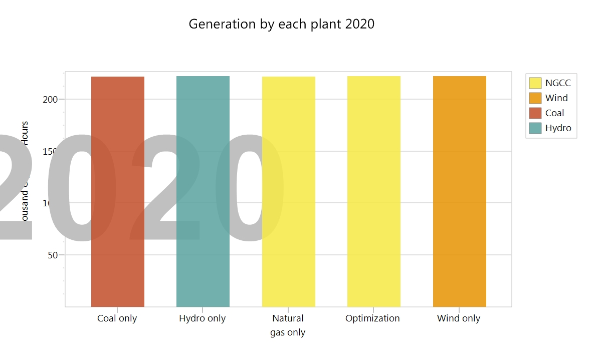

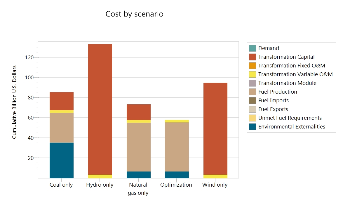

    At the 6th exercise on Optimization, when LEAP finishes the optimization calculations and shows the "Costs by scenario" graph, the optimization scenario doesn't include the capital costs. In addition, the electricity generation is only met by NGCC process without taking into account the wind system.
    I attach two pictures in order to illustrate the problem
    Thank you in advance!

    Thanks for posting this. We are aware of an issue with capacity expansion in optimized scenarios, introduced in a recent version of LEAP. We are working to resolve the problem, and will inform you via this forum thread once it's fixed.
