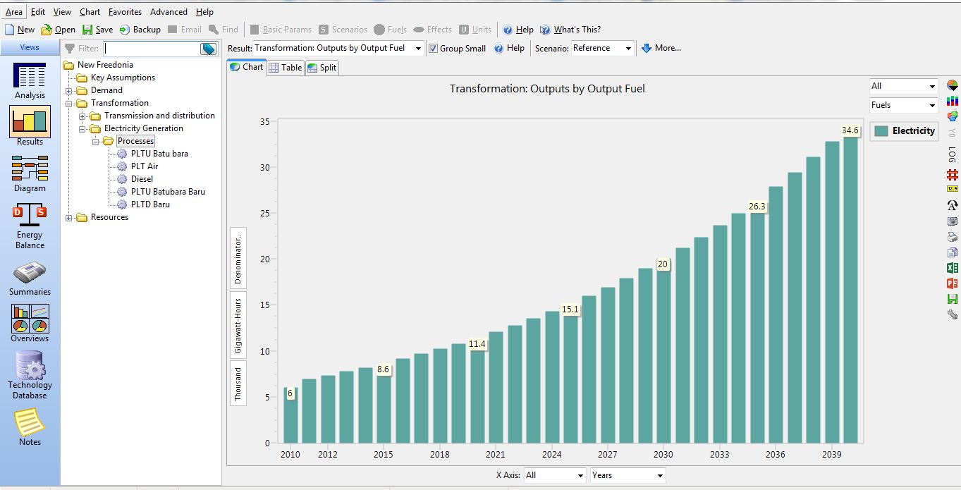

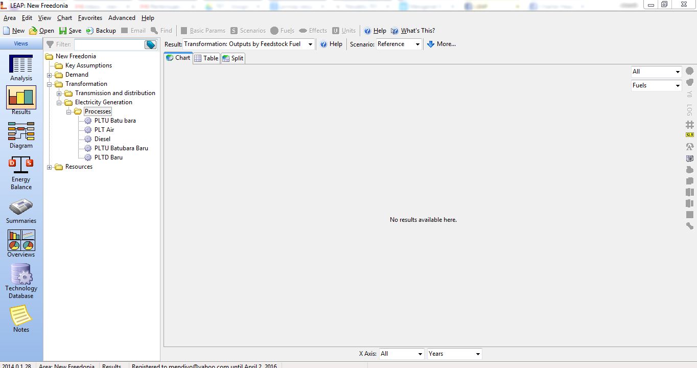

    Hi guys, it's my first experience with LEAP so i follow the exercise that LEAP provided. When I get into Transformation, more specifically in Electric Generation, I do all the following instruction and when i click the result, it just display nothing. When I changed the display options to "Output by Output Fuel", it displayed, but not with"Output by Feedstock Fuel". I really get confused there and i already repeated it for times and still get stuck. Any clue ??

    Please ensure that you're using the most up-to-date version of LEAP (currently v.2014.0.1.29), by choosing Help: Check for Updates, from the main menu.
    Does the problem persist after returning to Analysis view, selecting Area: Force Whole Area to Recalculate, and then returning to Results view? If so, would you be able to back up your model to a *.leap file and attach it to this thread?

    In Analysis view, select General: Results Variables to Save. Make sure that "Transformation: Outputs by Feedstock Fuel" is checked. This should allow you to view those results.
    I agree that the option to view these particular results should not be shown, if the results have not been calculated. We'll try to make that change in an upcoming version of LEAP.
