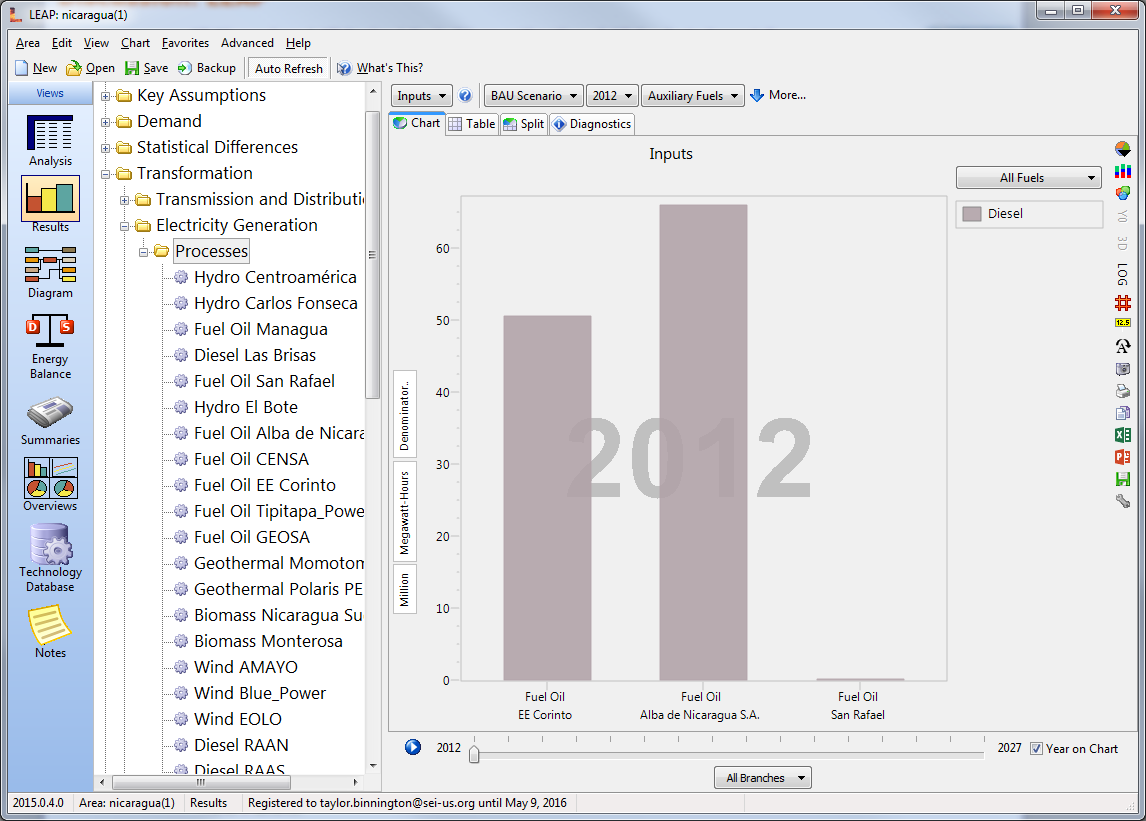

    Hi Maria,
    Although there is little electricity generated from diesel feedstock, you have added large amounts of *auxiliary* diesel consumption to some of your power plants. I've attached a screenshot from your model which shows Transformation: Inputs in 2012, for Auxiliary Fuels, with each of your power plants displayed on the x-axis.
  • María Mercedes Vanegas Cantarero 10/19/2015
    753 Views
    Thank you so much! This has solved the problem (allthough I don't know how and why I added auxiliary fuels).
