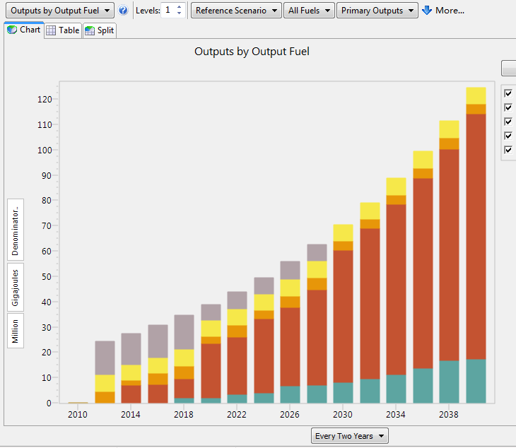

    I'm trying my best to finish the training,but when I meet with "1.4.3 Viewing results",something puzzled me.My result is strange,it does not show the data of 2010,and I do not know why.Just like the picture

    the data after 2010 is right,but in 2010 it show me 0.I post the new picture,thank you

    In the Freedonia exercises, the year 2010 is the "Current Accounts" year. This means that results for 2010 are the result of data entered under Current Accounts.
    As a first guess, I would suggest that you look at the Historical Production variable for each of your power plants and verify that you have entered all the data correctly:
    http://www.energycommunity.org/WebHelpPro/Transformation/Base_Year_Output.htm
