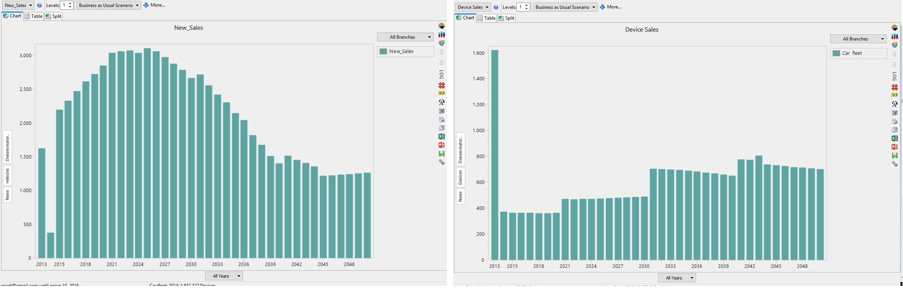

    thanks for your response. I can use the device retirements variable but I still have some problems in linking car sales and retirements.
    I have prepared a simplification of my model (attached) to show what is happening:
    The key variable New_Sales is defined as Car_Retirements+Stock_growth. After simulating some times It seems to be ok but when I use it to define car fleet sales it is not translated to Device Sales (see Fig.1.jpg).
    I look forward to hearing your reply. Lots of thanks.

    Thanks for your message, and sorry for the trouble. I can confirm that there is a bug in LEAP, which causes problem when trying to create a reference to a result variable.
    We'll be working on this for the next version of LEAP, and I'll post a message on this thread to let you know it's fixed.
    UPDATE 11/13/2015:
    This should be resolved in LEAP 2015.0.8.0. Please download it by selecting Help: Check for Updates, from the main menu.
