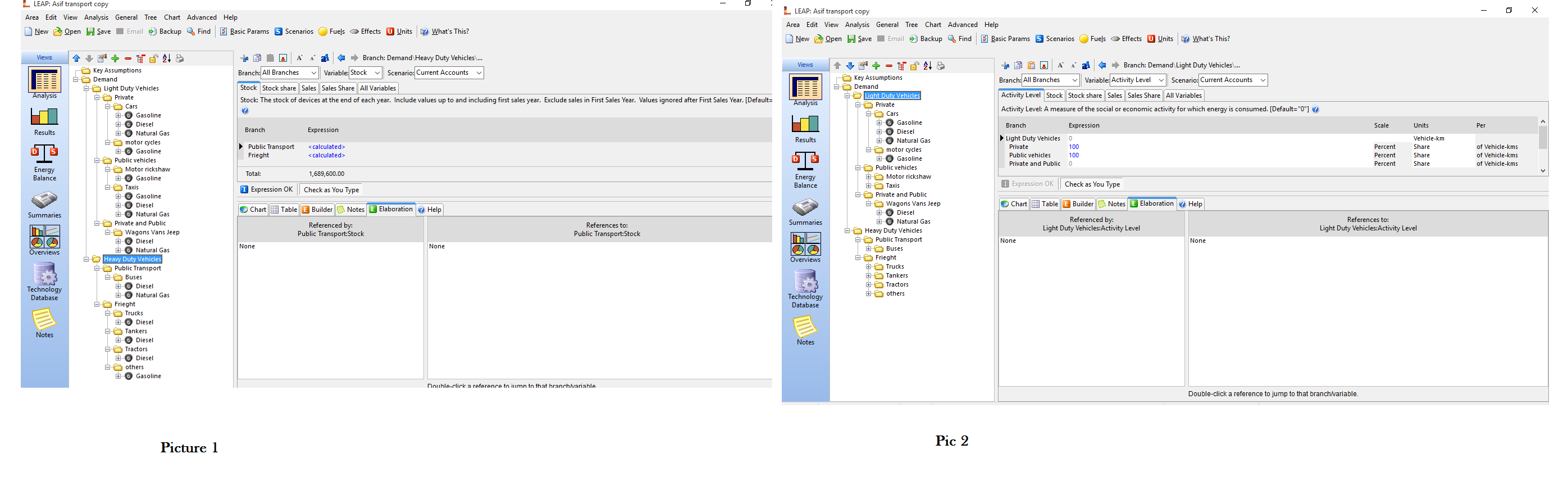

    I am working on transport of Pakistan and imported all data which I have. Now I find a problem of Activity level.
    I have attached picture 1 and picture 2.
    Why Leap is asking for activity level in picture 2. Which mistake is there.
    please resolve issue immediately.
