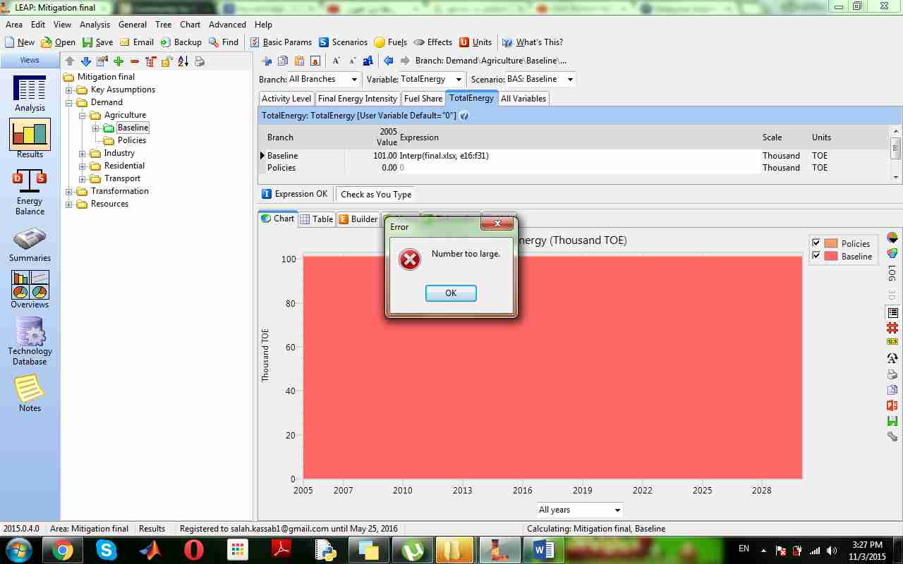

    I'm working on scenario analysis project, and when I run the result it gives me the error " Number too large"
    What that mean ?

    I can't be sure - can you tell me exactly when it appears? For example, does it appear immediately after you submit an expression using the Interp() function, which references an external Excel document? Or does it appear when you try to calculate results?
    Either way, please also make sure that you are running the most up-to-date version of LEAP. You can check by selecting Help: Check for Updates, from the main menu.
