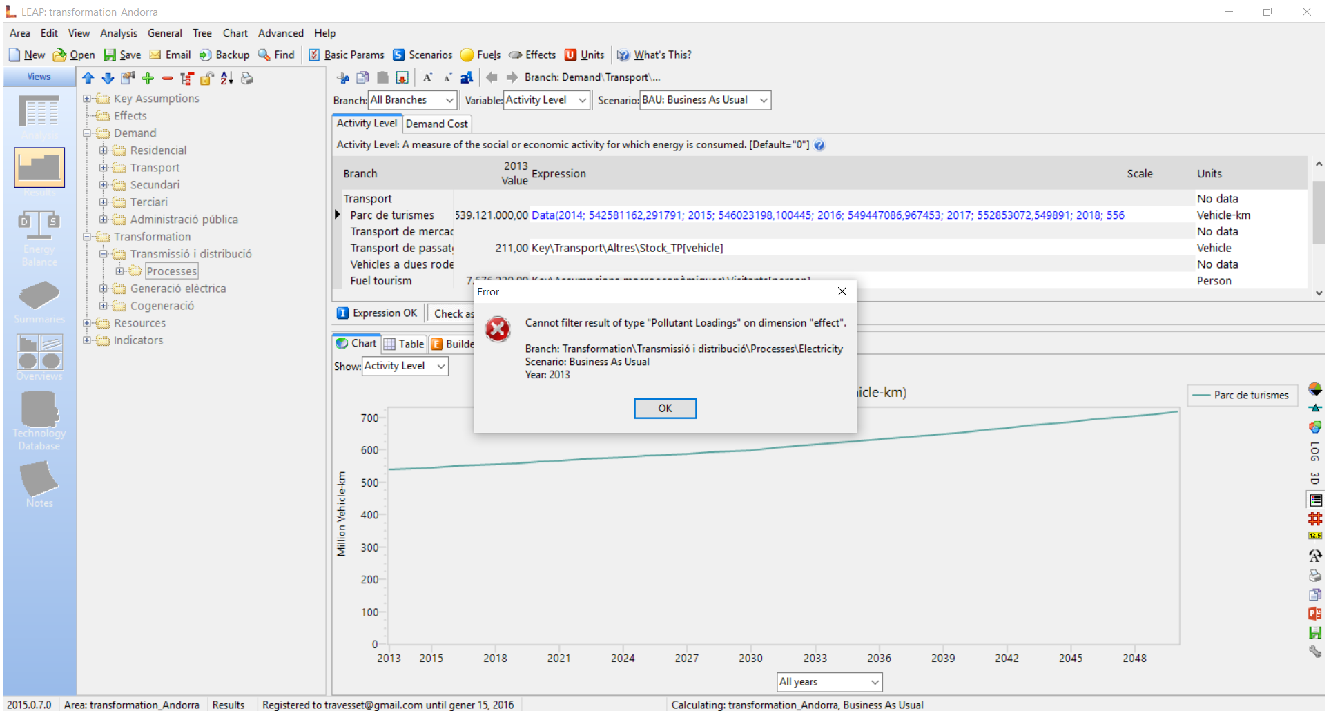

    I've just updated LEAP to the version 2015.0.7.0. When simulating with the new version an error in transformation sector appears (see attached .png). The model worked fine in the previous version. I tried to start again the modelling of the transformation module and the problem persists.

    This issue should now be fixed in LEAP 2015.0.8. Please can you download that? Sorry for the problems and thanks for your patience.
