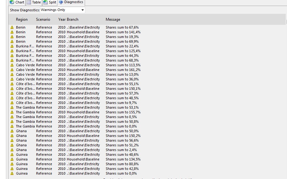

    I tried the solution proposed by switching off the Transformation section on the scope tab. in Basic Parameters and then by calculating results. But I couldn't find the demand branches which are incorrect. the calculation (without the gives me a "Read calculation diagnostic message" but then when I click on it I got too much information, I can even know where to start or what is the problem (PLs find atached)

    Double-clicking on any of those diagnostic messages should take you to the part of the tree where the problem is found. From the look of if, many of your percentage shares do not sum to 100% across adjacent branches.

    1. Unfortunately, I have a limited data availability and then I don't have the data of the fuel shares of all the technologies in my model. e.g. : for the household branche I would have for example electricity and oil but not gas or coal.
    I checked the box "do not check that that share values sum to 100%) as I don't have all the shares.
    However it looks like that doesn't work and I have to make them equal to 100%. Isn't it? How can I then resolve or workaround this issue (working on African countries, facing an unavailability of lot data).
    2. So when I disable Transformation & Resources in Basic Params, I am facing the issue above mentioned. And, no results. And when I add it, and recalculate my results, I get an "absolute convergence criteria (1000 Gj) larger than total final demand (-1,08819 Gj)" at year 2024. (this quite huge and I don't then want to just make criteria no more than 1% (I tried to do it but it doesn't work neither).

    Shares should add to 100% of any whole value - if you are lacking data, then your share calculation should be based on the known energy quantities.
    I expect that fixing your shares problem will also resolve your negative energy demand.
