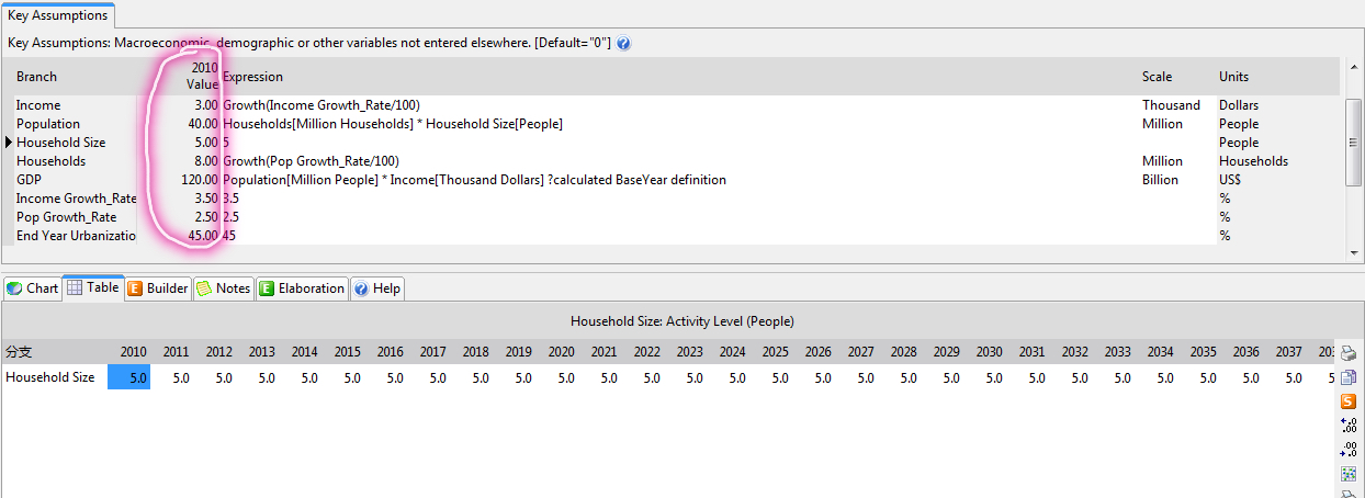

  • shi chen 3/14/2016
    371 Views
    it is shame to ask the question which is so easy but i just don't know.
    how to input the data in the picture which has been circled,just that "2010 value"
    thank you so much
  • Taylor Binnington 3/14/2016
    370 Views
    Hello Shi,
    These values are modifiable in Current Accounts, which is where you specify all data for the historical year(s) of your model. After these years and during your scenario time period, you are free to change values for each scenario separately.
  • Tongtong Ren 4/18/2016
    228 Views
    Hi Taylor,
    Thank you for your explanation, I'm having the same problem with Shi, Could you please specify how to do it? where I can find current account? I notice current account is under scenario, but I don't know how to get to the interface that I can change numbers.
    Thank you so much
    Amanda

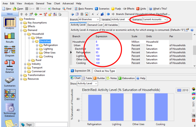

  • Emily Ghosh 4/19/2016
    226 Views
    Hi Amanda,
    You can change values in the Expression box, as shown in the screenshot below. If you would like to change the data for the Current Accounts scenario, ensure the "Scenario" drop-down menu is changed to "Current Accounts".
