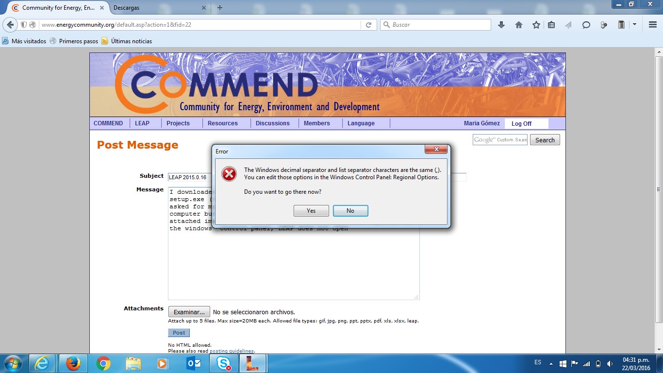

    I am having trouble with the installation of the current LEAP version (2015.0.16. I executed the file setup.exe (53.6 MB) following the instructions. I was not asked for my license information during the process. Now I have the files in my computer (and a direct access icon) but I am not able to open LEAP. When I try to open it, I get an error (see attached image) and even if I modify the sugestted options in the windows control panel, LEAP does not open. I have tried in my personal laptop (windows vista) and in my work computer (windows 7) but I did not get positive results. Could you please provide some ideas to succesfully install the last version?. I didn´t have older versions installed in my computer, this was the first attempt.

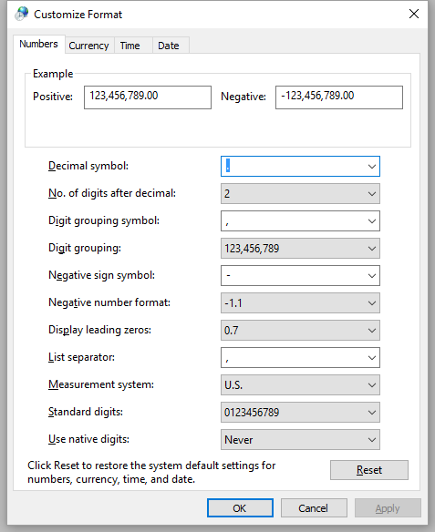

    Forgive me if I've misunderstood, but can you confirm that the decimal and list separator are *different*, in your computer's regional settings? I've provided a screen capture of my own settings, which shows that the "Decimal symbol" and "List separator" operators are different from one another.

    Thank you Taylor. I changed the list separator!
    Now LEAP is ready
