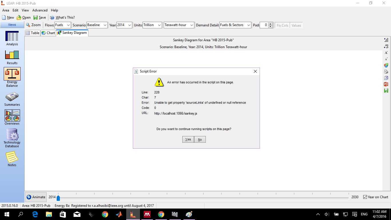

    Hi Taylor,
    I made a mode of electricity system for three different region, said region A, B, and C. I set demand for each region with electricity A, electricity B, and electricity C. the same thing I did in transmission system and power plant. however, I used the same primary energy for transformation process in all region to produce three kind of electricity. when I ran this model, I had error in energy balance and couldn't display sankey diagram...
    in result view, everything seem no problem.
    please, you input will be very useful...
    regards,
    rahmat

  • Rahmat Al hasibi 4/7/2016
    245 Views
    Hi Taylor,
    thanks for the replay.
    to answer your questions:
    a. I just run the model, and go to the energy balance, and view the sankey diagram. I got error message as in the attached file.
    c. no, I am not using region feature
    d. I defined three kind of electricity as separate fuel, for instance electricity A is just for region A, and so on...
    thanks...

  • Taylor Binnington 4/15/2016
    230 Views
    Thank you, Rahmat, I've received your model.
    UPDATED 04/15/16 (original response was not accurate):
    You are experiencing the problem because you have assigned the same name to both a transformation process and the module's output fuel. In your model, this occurs for each of your three transmission and distribution modules.
    We'll try to address this for the next version of the software. In the meantime, I suggest modifying the name of your of your transmission processes so that they are different than the name of the module's output fuel.
    Very sorry for the inconvenience,
