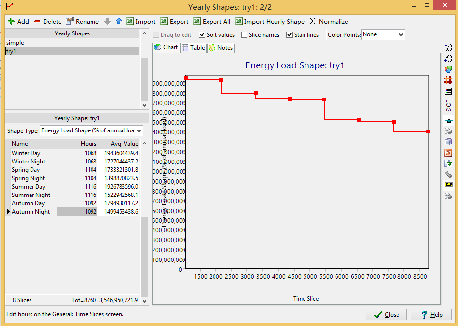

    After i input the hourly data ,the chart's y-axis of the "energy load shape" is different with that in manual,Please see picture 1.

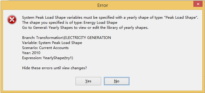

    And then when i follow the forth step-choose "system peak load shape",leap tell me there is error(see picture 2),could you please tell why ?

    Both the Energy Load Shape and the Peak Load Shape options for inputting load curve data require that you enter values which are *percentages* of annual energy or peak load, respectively. Each of the numbers you have entered is clearly larger than 100%, which is causing an error to appear.
    Please review these two help files:
    http://www.energycommunity.org/WebHelpPro/Transformation/System_Peak_Load_Shape.htm
    http://www.energycommunity.org/WebHelpPro/Transformation/System_Energy_Load_Shape.htm
