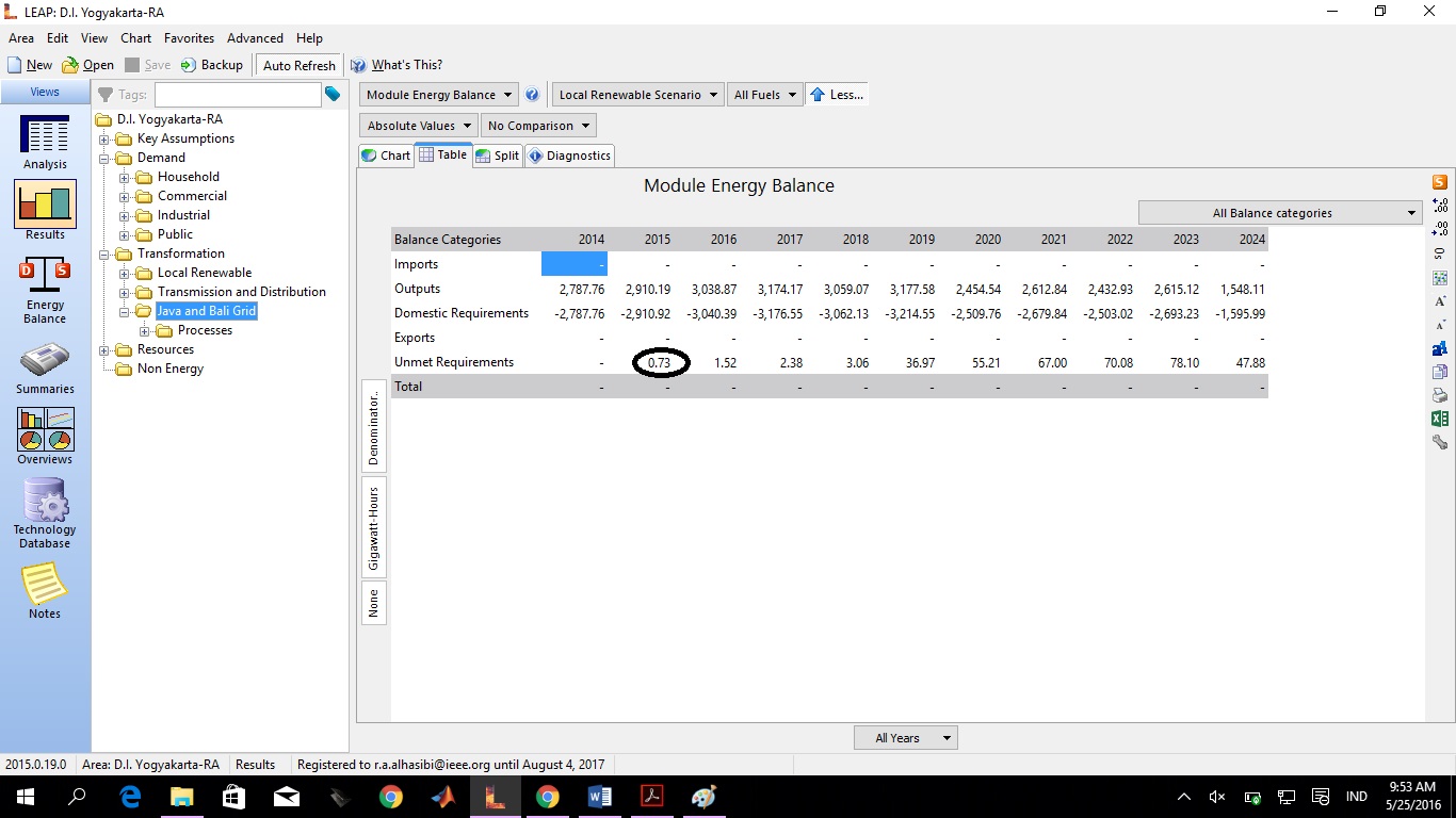

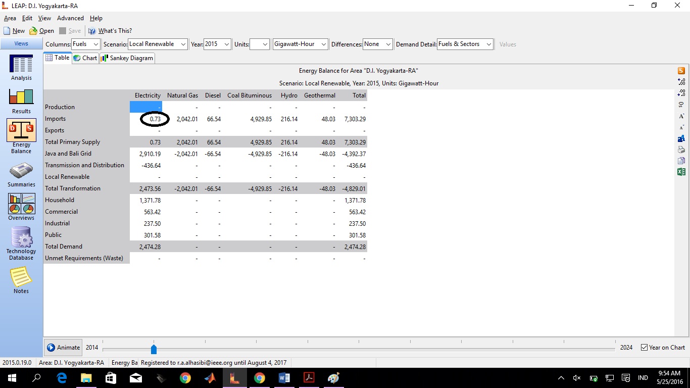

    Hi Taylor,
    I construct a model that output properties of electric generation set to "Requirements remain unmet". This results some "Unmet requirements" in module balance table. But, this value appear as an imports in energy balance table as shown in attached files.
    Tks.

    Hi Rahmat,
    Thanks for your question. Recall that LEAP's calculation order is from the top branch downwards. Therefore, while there may be unmet requirements at a particular module (per the first image showing the "Java and Bali Grid" module energy balance), the resource requirements may be met by a branch lower down the list (as shown in the overall energy balance). Since there does not appear to be any other Transformation processes below "Java and Bali Grid", right-click to review the properties of electricity under the Resources branch and ensure that any remaining requirements stay unmet.
    Resource Properties: http://www.energycommunity.org/WebHelpPro/Resources/Resource_Properties.htm
    Hopefully this helps! Please let us know if you have any other questions.
