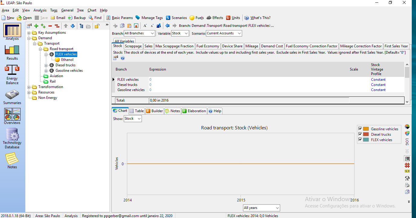

  • Pedro Gerber 11/27/2018
    Hi Emily,
    For me is a bit strange, because the user guide uses the term "survival", however, LEAP it uses the term scrappage.
    I am sending you a prynt screen. Maybe you can help me find my mistake.
    Pedro

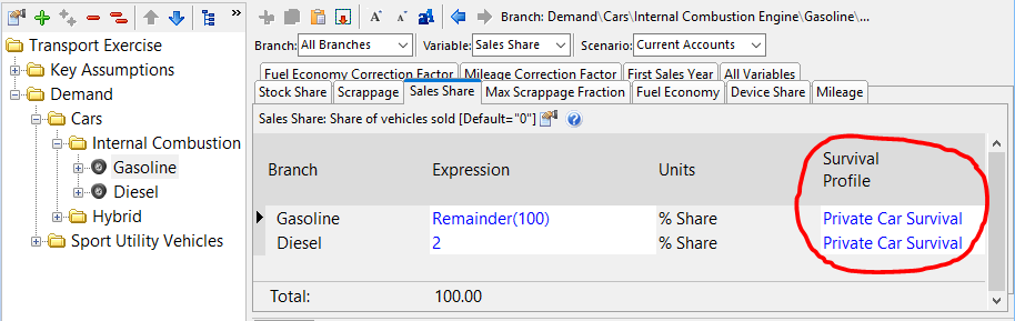

  • Emily Ghosh 11/27/2018
    Hi Pedro,
    Thanks for your question. In LEAP, vehicle survival is inputted as a "Lifecycle Profile", a feature that can be accessed through the "General" menu. For more information on creating a life cycle profile refer to the following help page: https://www.energycommunity.org/Help/Supporting_Screens/LifeCycle_Profiles.htm.
    The vehicle survival profile specifies the amount of remaining stock of a particular vintage in the years after being sold. In a vehicle survival profile, the first sales year will have 100% of vehicles, and over time the number of vehicles of that vintage will slowly retire until the number of vehicles reduces to 0. You can link the vehicle survival profile to a vehicle branch through the "Sales Share" tab (see attached screenshot).
    Vehicle scrappage, on the other hand, represents the number of vehicles that are retired or "scrapped" early (so it kind of overwrites the retirement rate specified in the survival profile). For more information on scrappage, refer to the following help page: https://www.energycommunity.org/Help/Demand/Scrappage.htm.
