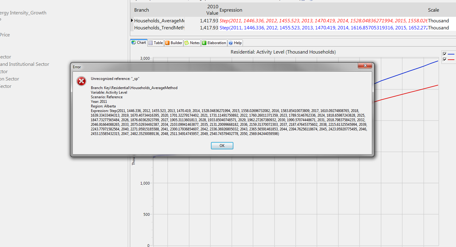

    After the update I get an error message when trying to run results. This model would run fine with the previous software version. I have attached a screen shot of the message. If there is not a quick fix then access to download a previous software version would be very helpful.

    Thank you for your post. To try and resolve the issue, go into the expression that is causing the error, add a space at the very end of the expression and press enter. This will recalculate the expression and may fix the error.
    Since the cause of the error message is not immediately apparent, if you don't mind, can you please send a copy of the LEAP file for us to review? To do so, go to "Area: Backup" to create a backup LEAP file and save it to your computer. Then either reply to this message and attach the file or send it via email to leap@sei-us.org. We'd like to look into the error to prevent this issue from occurring in the future.

    The latest version of LEAP (Version 2015.0.27.0) fixes the error with compiling expressions. Your model should work after LEAP is updated. Thank you again for emailing the file and for making us aware of the issue.
