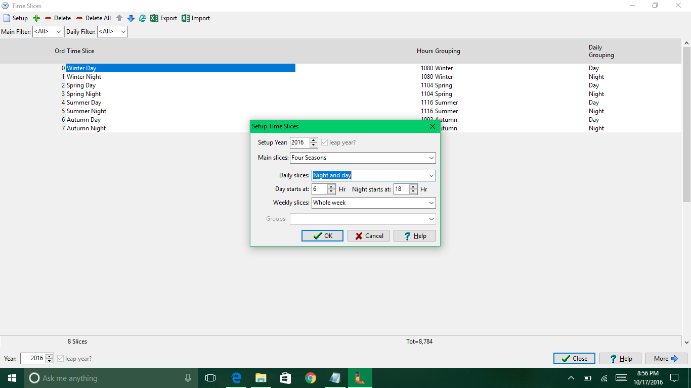

    2. Regarding the issue with "import hourly shape" function, I am using the latest version of LEAP you released and my time slice arrangement and number is depicted in the attachment in this post. Unfortunately, I have discovered that I am unable to use that function almost ever! I created the simplest excel file with only two columns: hours in one year and energy consumption in each hour in kWh. Then I open only that file and LEAP on my computer.  When I access "import hourly shape" it asks for the type of load shape and range in excel, but it does not recognize any range or whatsoever! I tried specifying different types of load shape under "import values as" function and made appropriate adjustments to my hourly data (% of annual peak or % of annual load) but still no results. The last solution I resorted to is opening your "sample load shape" file provided along with LEAP Training Exercises pdf and used in Exercise 6 (Optimization exercise), and then substituted hourly data in that file with my own data, in which case LEAP recognized the range defined in that file (called "kWh"). Please let me know if I was doing something wrong.

    1. To easily generate time slices, use the time slice wizard by going into General > Time Slices > Setup Time Slices > Detailed (in the same manner as Exercise 6 and as shown in your attachment). Then, specify the "Main Slices" according to your preferred level of detail (i.e. 8760 hours = 8760 time slices). You can also define daily or weekly slices, however these options are only available for Main Slices that are at a high resolution, like seasonal or monthly slices. Further information on setting up time slices can be found here:
