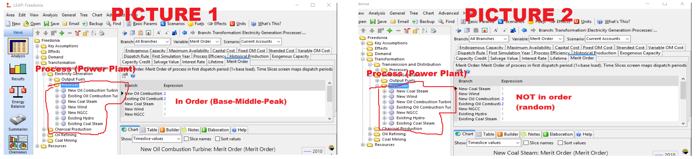

    As I knew from LEAP Training Exercises, section 1.4.2. Electricity Generation, the process module from electricity generation must be reordered. I have a question :
    1. Are there any negative impact (for LEAP's calculation) if we placed the power plant not in sequence (not in base-middle-peak merit order) ? (see attachment)
    Because I have huge number of power plants and I wonder if power plant placing in sequence of merit order has any impact in calculation.
    Thank you so much for anybody who reply and answer my questions. I really appreciate it.
    Best Regards,
    Tri Ilham Wicaksono

  • Tri Ilham wicaksono 12/9/2016
    Dear Kamia and Emily
    I think i knew the meaning of Kamia question.
    "So, how can LEAP decide which one is base/intermediate/peak load if we do not define the merit order number of each process?"

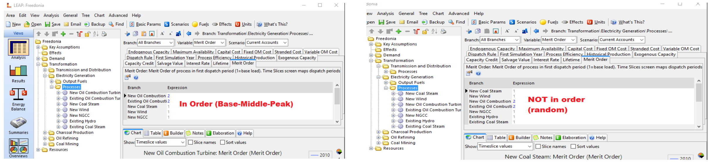

    In order to understand my explanation, while read this, see atachment below
    My early question was about "How if process (in this case Power Plant) is added not in sequence or randomly placed?" (i.e. processes in Picture 2)
    That's does not mean we do not add the Merit Order
    We still add the merit order properly in every process (i.e. Power Plant), but my early question is "What if the power plant placement is not in order"
    I mentioned about "order of placement" because as I have already read from LEAP Training Exercises, section 1.4.2. Electricity Generation, it is mentioned that the process module from electricity generation must be in sequence. And if the order was not in proper place, I thought there would be some error in simulation, and so on.
    And Emily answered my question "That's not a problem because LEAP will still do simulation automatically (based on Merit Order that we have already inputted in every process of power plant), and does not based on the sequence of Power Plant placement in LEAP"
    So both Picture 1 and Picture 2 will have same result because the processes in both Picture 1 and Picture 2 have same merit order.
