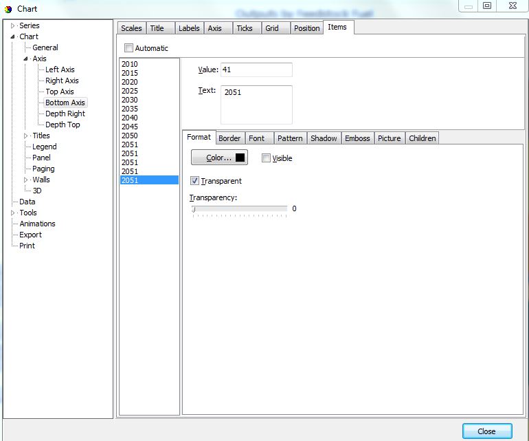

    I encountered some difficulty controlling the years that show up when exporting charts via EMF. In the wrench menu, I selected Bottom Axis, Scales and then Increment. I attempted to set the increment to five years, to be consistent with our other exported charts. However, all the exports have a scale of roughly 3 years. I was able to create a work around using the Items tab. However, I could not remove some of the items listed. I toggled the "visible" checkbox, but they still showed up on my image exports. To make these extra years go away, I needed to assign them as a year outside the range of the chart. I thought this might help to know for future versions.
