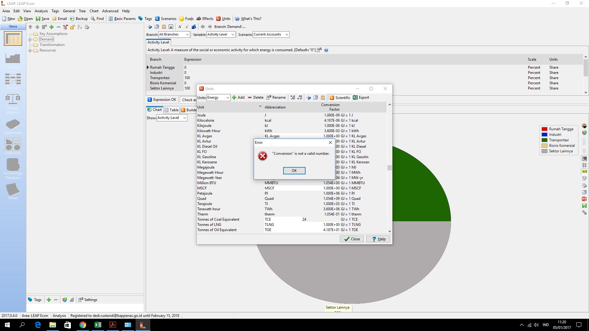

    Hi There,
    I need your help to solve my problem as I cannot edit and modify conversion factor for my additional energy unit. I want to change value for Tonnes of Coal Equivalent from 29 to 24 but there is messege that the conversion is not a valid number. Fyi, I am using LEAP version 2017. Thank you.

    Hello Dedi - I can also replicate this issue. I will try to get it fixed in the next release of LEAP.

    On a related point, are you sure you want to change the definition for TCE? Normally this is fairly (but not totally) standard. In most cases people want to edit the energy content of their coal (in the General: Fuels screen), rather than edit the TCE definition.

    Thank you for your quick reply.It's a good idea but I thought it would not help if I want to develop a model with demand using Total Energy not using Energy Intensity. So I try to convert it as well as add some more additional energy unit based on mass/volume such as Ton LNG, Ton LPG and KL Gasoline and diesel. This is also to accomodate statistical data that commonly provide only in that unit.
