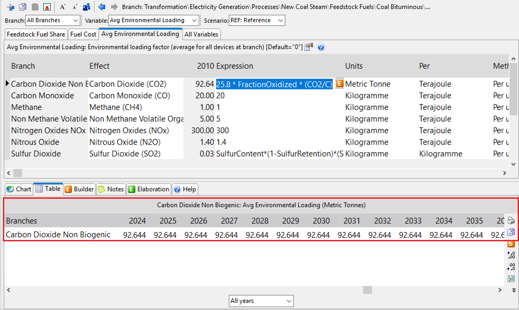

    I have a similar issue: when multiplying amount of fuel consumed (kWh) by the the expression (kilograms/kWh) I get higher emissions than what LEAP presents. Is it related to the % oxidized used in the software and that I am not considering in my calculations?

    Hi Jose,
    If you are using different emission factors than those in LEAP, it will lead to different emissions results. If you are unsure of the emissions factor value that LEAP is using, you can view this in Analysis View by selecting the effects branch you are interested in and viewing the table below the expression box (see screenshot below).
    Also, note that LEAP's emissions factors are typically based on IPCC's default values. You can change the values in the Environment Loadings tab to the emissions factors you are using in your own calculations if are more representative of the emissions factors in your area.
