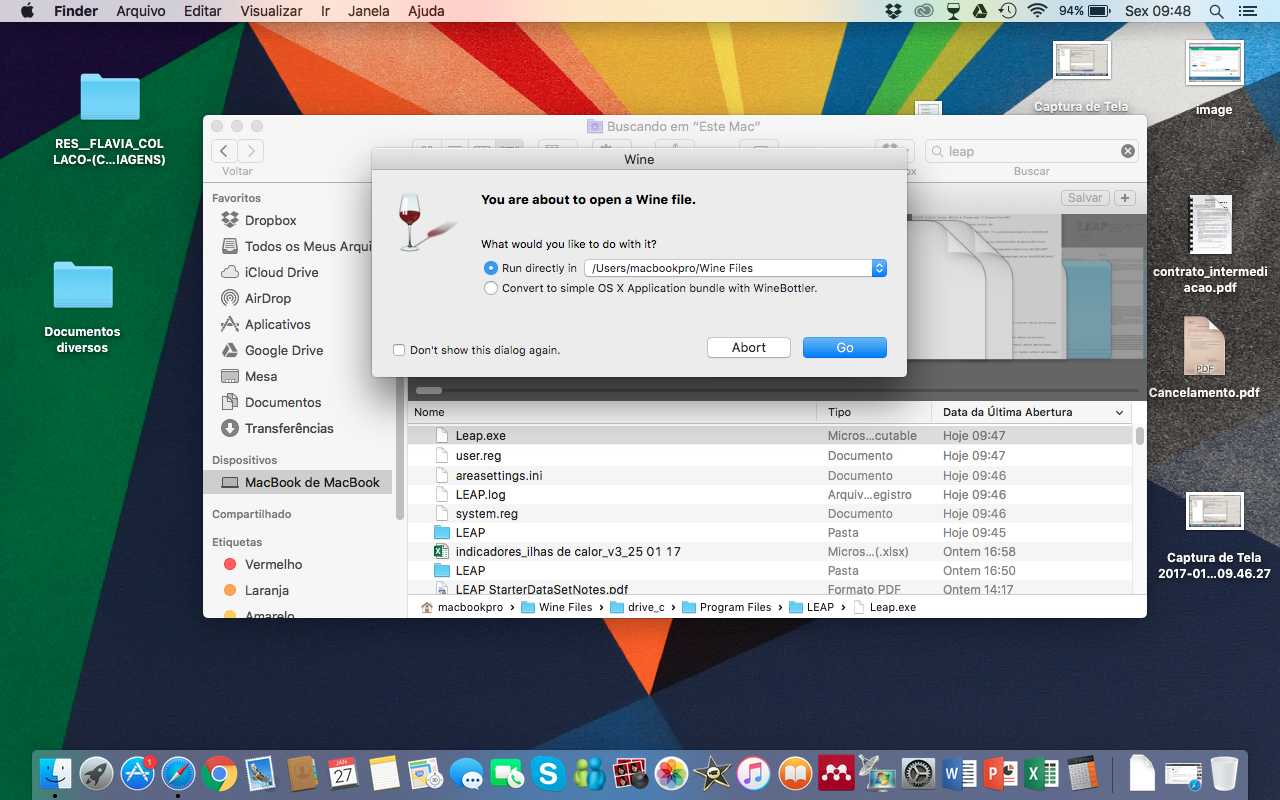

    So I downloaded the "vine bottle" package, and after, I downloaded the last version avaliable of LEAP at the website. It's instaledBut every time that I open the program, this message from the second picture that I'm sending you shows up.
    The first pic it is the first thing that I do to open the program.

    For running LEAP on "Wine" I had to install the "WineBottler" version 1.8 at the official site of the program.
    So I downloaded the last version of “WineBottler”, and after it was downloaded I double clicked at the dmg archive, first I dragged the "Bottler" to the applications folder, and after you have to dragged the "Wine" to the applications folder as well, and it was installed (there are a lot of youtube videos that teach how to install winebottler, I used this one: https://www.youtube.com/watch?v=J7kwYmrrSto)
    Then I installed the last version of LEAP.
    So, for running LEAP, first it is necessary to open the "Wine", and inside "Wine" folders it's going to be LEAP program. So, double click in LEAP.exe and "Wine" will ask if you want it to run directly in Wine Files, or if you want to convert to simple OS X application bundle with WineBottler. I always run directly on Wine, never try to convert to simple OS X application....
    After you chose to run directly LEAP it’s going to open.
