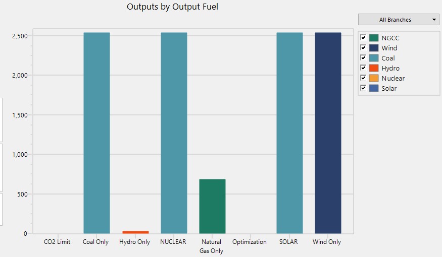

    I am working on LEAP - Least Cost Optimization module. The attached picture is achieved by clicking the Analysis View. The optimization bar is blank, Don't understand the issues. Kindly guide me, sir. Sir, I also have one more question i.e. Is exercise 1 of LEAP training manual is necessary for adding to perform the LEAP - Least Cost Optimization exercise.

    Exercise 1 is not necessary in order to complete Exercise 6 (optimization).
    As you work through the basic training exercises you can check your work against a pre-completed version of each exercise. Simply save your work, then open the LEAP area "Optimization Exercise", and select Area: Revert to Version, and choose the "complete" option. This will help guide you if you get stuck. We're happy to assist through the forums as well, but you need to provide a complete description of the problem you're seeing, what you expect to see instead, and why you expect to see that result.
