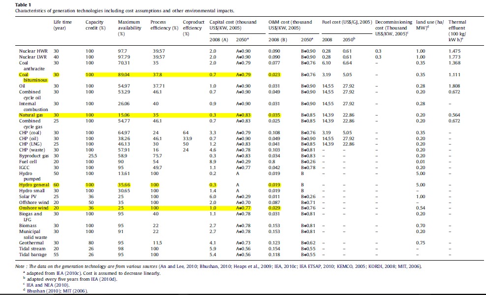

    I am currently working on Least Cost Electricity Generation Module. I am facing
    some issues regarding O&M cost. The O&M cost (Reference table is attached) is not available in separate fixed O&M and variable O&M cost.

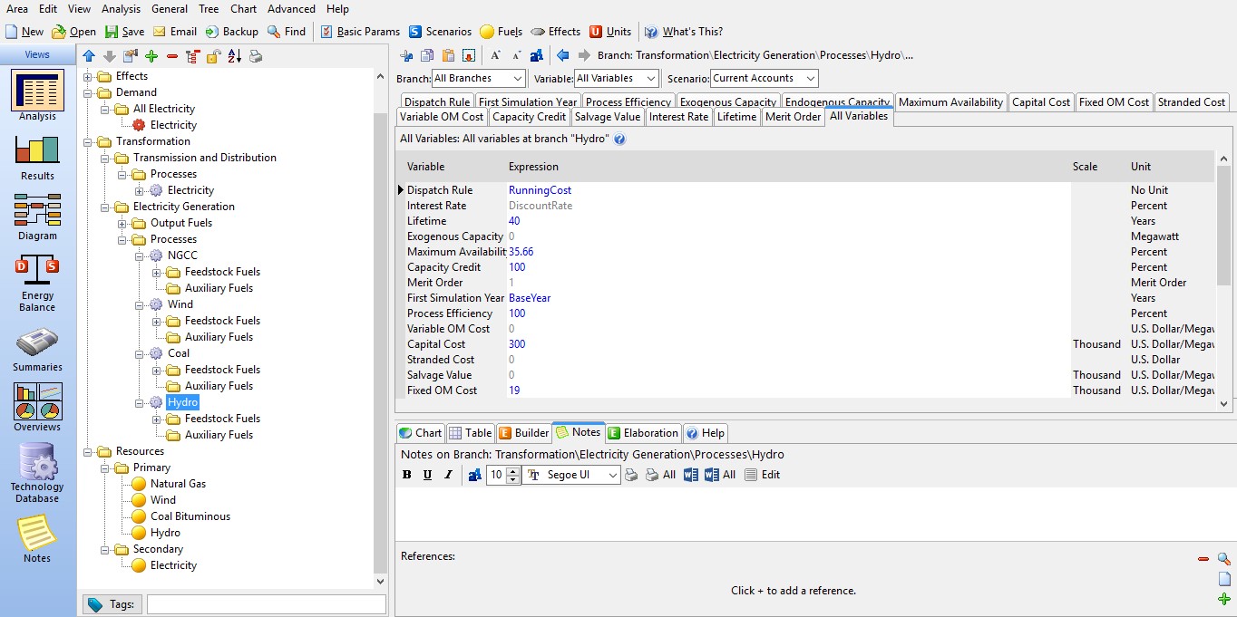

    I am using this O&M cost in Fixed O&M variable in LEAP. Kindly suggest
    and advise.

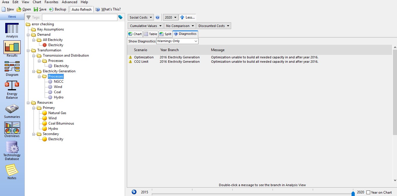

    After putting these values in NGCC, WIND, COAL and HYDRO, I have received an
    error when clicking Analysis view. The error file is attached.
    Looking forward your valued response. Regards

    Occasionally, useful data sources group all O&M costs into a single cost per kW of installed capacity. But this assumes a level of capacity utilization, which you will need to recover if you wish to enter both fixed and variable O&M separately. In other words, your table provides you with the variable OM_total in the following equation:
    OM_total ($/kW) = OM_fixed ($/kW) + OM_variable ($/kWh) * 8760 (h) * CF
    ...where CF = the average annual capacity factor of the technology. LEAP requires both OM_fixed and OM_variable separately.
    I can't speculate as to the cause of the warning you see in the third screenshot without more information. Have you included any constraints on the amount of allowed capacity which could prevent LEAP from constructing enough to satisfy capacity requirements?

    I have linked the 'maximum capacity' to the 'exogenous capacity' for each power plant, which I guess is practical.

    I'm not quite sure why you would want to constrain total installed capacity to the values which you have entered in the Exogenous Capacity variable. This implies that LEAP would never build any new power plants that are not described entirely through exogenous capacity.
    if this were the case, it's quite possible that the optimization routine would be unable to build sufficient capacity to meet requirements (as the diagnostic message indicates). This does not mean that the optimization "failed", but only that the contraints kept enough capacity from being built.

    Second - the "no primal feasible solution" generally means that you have assigned two or more model constraints which directly conflict with one another. A simple example would be setting the Minimum Capacity Addition variable for an (optimized) transformation process to zero, while also setting the Minimum Capacity variable to something greater than the Exogenous Capacity. This tells LEAP that it must build new capacity to satisfy one constraint, but cannot build any capacity due to another constraint - hence, no solution.
