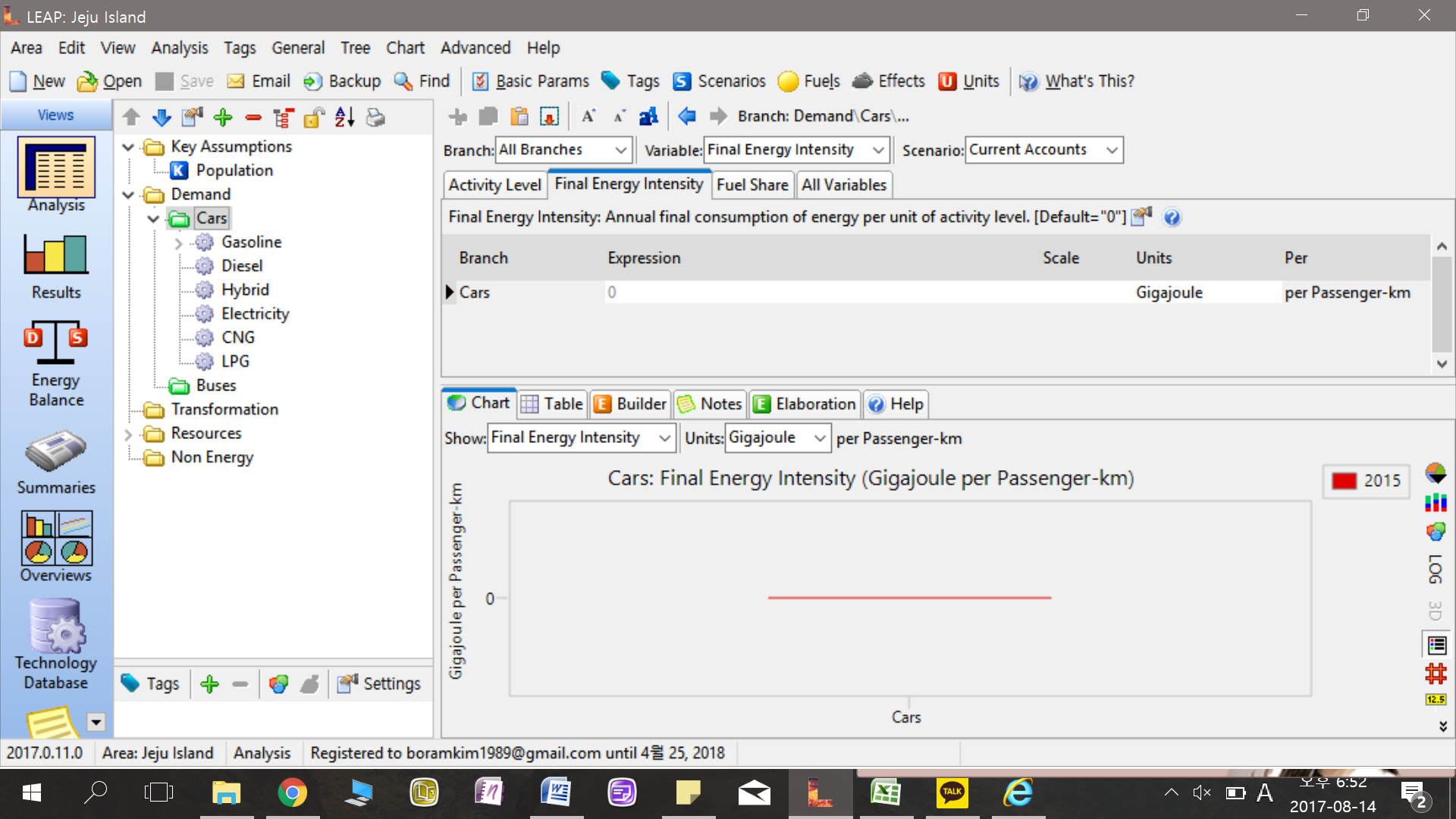

  • Boram Kim 8/14/2017
    Thank you so much for the support!
    I've looked at the whole thing and am trying to start it all over from normal (non-stock turnover analysis) settings
    but i can't find a space to enter in fuel efficiency which was available in the stock turnover version.
    Do i need to calculate passenger km myself as shown in the attachment image?
    The thing is i have no information on load factor or population etc.
    thanks again!
    Boram
  • Emily Ghosh 8/17/2017
    Hi Boram,
    You may want to use vehicle-km instead of passenger-km for the Activity Level variable since you know the number of vehicles. You will need to make an assumption on the annual vehicle-km per vehicle in order to calculate total vehicle-km. A quick Google search revealed a few sources with information on annual vehicle-distance per vehicle that may help get you started(disclaimer: I haven't read these sources in detail):
    You can enter the fuel economy in the final energy intensity variable. Recall that fuel economy is defined as energy consumption per unit of vehicle-distance traveled (or its inverse, in the case of MPG). For example, if you know a vehicle's fuel economy in MPG, then calculate its inverse to find the gallons per mile and enter this value in final energy intensity (you will need to change the units accordingly).
    Also, currently the way your branches are set up, the same final energy intensity (or fuel economy) will apply to all car types (i.e. electric cars will have the same fuel economy as diesel vehicles), even though fuel economy usually differs between car types. Instead of using the green-colored Categories with Energy Intensity folder for the branches labeled "Cars" and "Buses", if you were to use the yellow-colored Categories folder instead, you would be able to enter different fuel economies for each vehicle type (note that you can't actually change the property type of the branches, you will have to re-create your entire structure if you choose to implement this suggestion).

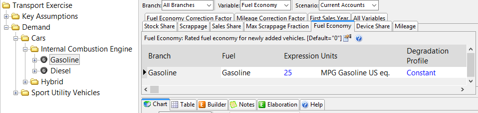

  • Prativa Gautam 10/24/2017
    Ii can't find a space to enter Fuel economy in stock turnover method which was available in the activity level version.
  • Emily Ghosh 10/24/2017
    Hi Prativa,
    If you are interested in conducting a transport stock turnover analysis, be sure to add the branch type called "Transport Technology (Stock Turnover Method)" (the branch will have a wheel icon in front of its name). Then, when you click on the transport technology branch in the tree, you should be able to see the Fuel Economy variable. I've included a screenshot for your reference.
