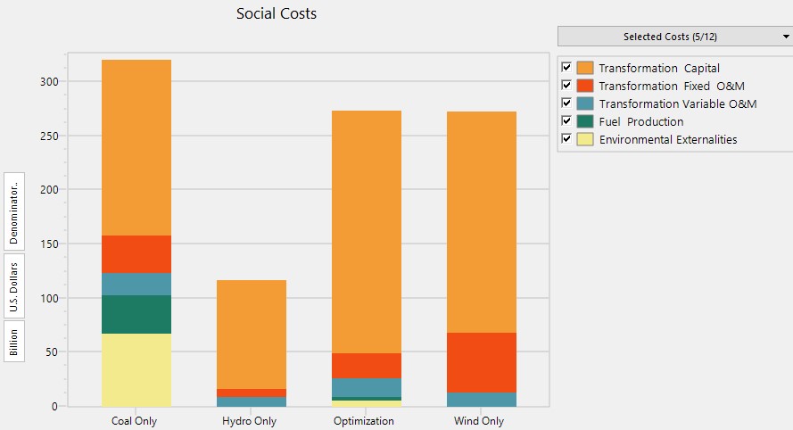

    Hope you are fine. Sir, I am working on Optimization Module of LEAP. I am facing some issues regarding Optimization results. That is why my optimization cost is higher than hydro. The snapshot is attached below.
    I am looking forward your response.

    Hi Asim,
    You have only selected 5 of 12 social cost categories in the results view. If you select all 12 cost categories, are the Optimization costs still higher than Hydro scenario?

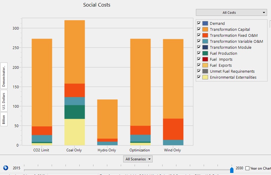

  • Asim Amjad 6/14/2017
    Yes, it is still higher. Guide me what should I have to do now??
    Regards
