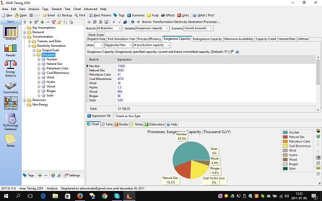

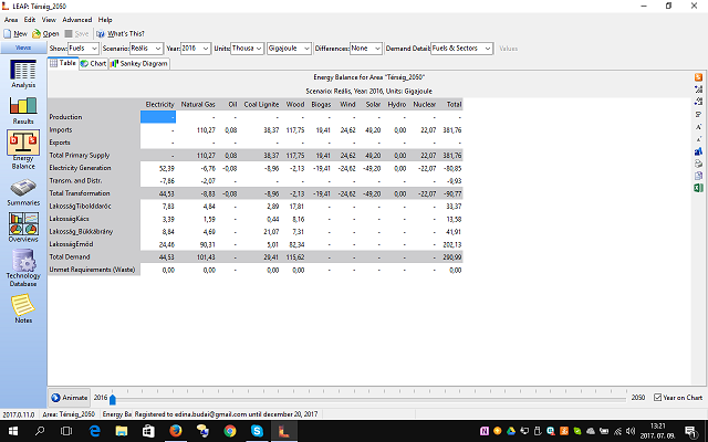

    Thanks a lot for your reply. I try to explain the
    problem a bit more detailed. So I filled at the Transformation part the
    Electricity generation. Photo attached (processes). Then I checked the
    energy ballance and I see all the datas at the Import row (energy
    balance picture). So my quistion is where I need to put datas to have
    the numbers at the production part? If it is necessary I can attach more
    pics about other part of the analysis.

    I think you may have read the energy balance incorrectly because it is not showing any Electricity imports in the first column.
    Note that the row called "Production" refers to the production of primary fuel, or a fuel that has not been converted or processed (e.g. coal, natural gas, nuclear, hydro, wind, solar, etc.). The production quantities are typically specified in the Resources branch for each primary fuel. The "Production" row does not show the amount of electricity being generated because this is a secondary fuel created through a transformation process. The amount of electricity generated is shown in the row called "Electricity Generation".
    For more information on the Energy Balance table, please read through the following documentation: https://www.energycommunity.org/Help/Views/Energy_Balance_Tables.htm
    Also, for definitions of the terms used in the Energy Balance table, please refer to the IEA website: https://www.iea.org/statistics/resources/balancedefinitions/
    Hopefully this helps!

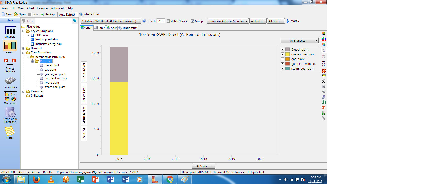

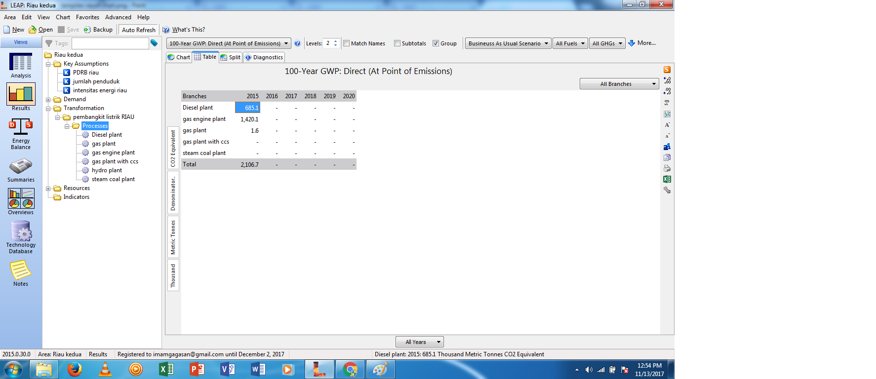

    I am a student from electrical engineering in Riau Province Indonesia. Currently, I am doing a research on GHG emissions from thermal power plant. in the transformation branch, i already link all the technology with the TED in environment loading. but when I see the result, its just showing the base year and the next year is 0. The result just comes from 2 power plant and another power plant is 0. I am expecting the result will raising significantly over 5 years with 2015 as a base year, 2016 as first scenario year and 2020 as a final year. I attached the file below with the password 082387923219. I really appreciate the help that I get.
  • Taylor Binnington 11/22/2017
    Hi Imam,
    First check to make sure that your power plants are producing energy, by viewing the result Transformation: Outputs by Output Fuel. If no energy is being produced, then there will be no emissions.
