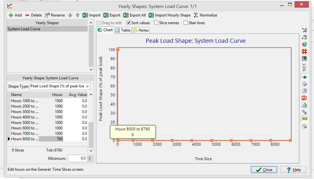

    I tried to solve the leap training exercise number 1. In electricity generation section I could not got the system load curve and everything showed zero.
    Why that happened?
    I attached the files
    Thank you
  • Taylor Binnington 7/27/2017
    Hi Albert,
    Can you provide an exact set of steps that you tried? From your screenshot, it doesn't look like you've tried typing any numbers into the yearly shape, where it currently reads "0.0".

    As I said, I'm trying to solve the exercise number 1 in 'leap training exercises book' that I downloaded from this site. From the start of that exercise ,step by step did everything that was mentioned in that book and everything went well but when I'm trying to got this curve "system load curve" I found everything was zero. Maybe in the book something was not mentioned and I should do something else.
    you said, I should type something into the yearly shape, but in the book anything was mentioned for typing in the yearly shape. Where is it?
    What is your idea for this problem? How can I solve this problem?

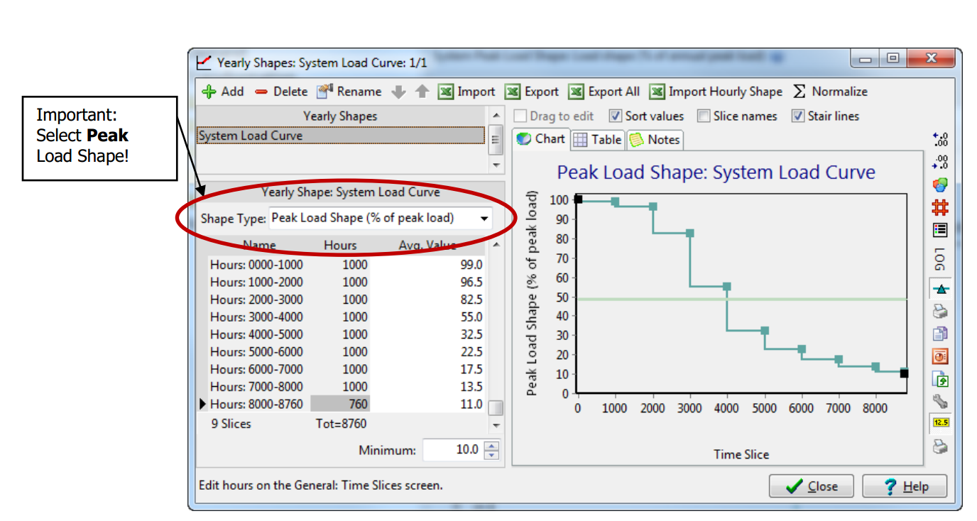

  • Taylor Binnington 7/28/2017
    Hi Albert,
    At the bottom of page 23 of ouf basic training materials, you are instructed to "Enter the values as shown in the screen below". You must enter the numbers yourself - the screen shot shows the completed portion of the exercise.

    I got it...!!!!
