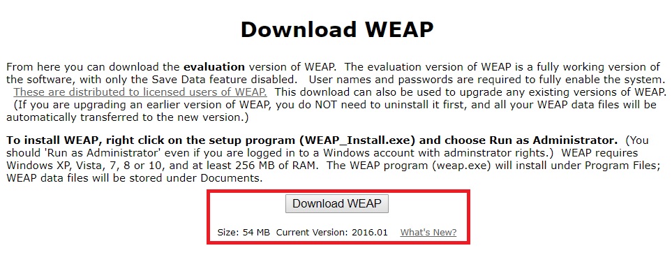

  • Mostafa Fard 7/25/2017
    As I said before, the latest version in WEAP site is 2016.01 (I downloaded the latest version of LEAP, and WEAP). The latest version of LEAP needs WEAP 2016.02 or later, but the latest version of WEAP is 2016.01
    Am I wrong???

  • Taylor Binnington 7/26/2017
    Hi Mostafa - I apologize for this. This version of WEAP is not publically downloadable from the WEAP website. I've emailed you a direct-download link.

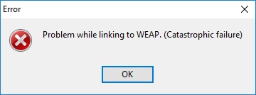

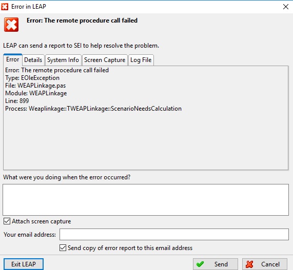

    Hi again dear Taylor,
    I got the new version of WEAP, but I have the following errors:
    1) If I run WEAP and select Weaping River Basin in Open Area window, it works correctly. But, if I select Tutorial and click on OK, WEAP will wait for ever without any reaction (I finally kill it via Task Manager).
    2) If I run LEAP, I will have a message to start WEAP. I click OK and WEAP will start. Again, WEAP will crash and wait for ever. Also, LEAP throw a Catastrophic Failure and after I click OK, nothing will happen. LEAP will wait like the other tool until I kill WEAP via Task Manager. I also have a random error in LEAP (I could not find the process) which I attached its image.

  • Taylor Binnington 8/15/2017
    Hi Safwan and Mostafa -
    Sorry for the wait. I am not able to reproduce the problem you have observed, Mostafa, using my own computer. Are you certain you're running the latest version of LEAP as well?
    Try opening the "Tutorial" from within WEAP while LEAP is not running. Please let me know if you continue to see the same error.
