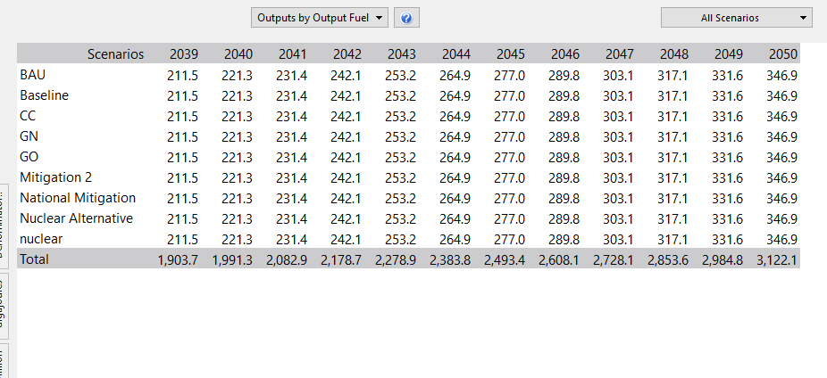

  • Arwa Jaradat 5/11/2018
    Hi again
    If I create many scenarios based on the baseline scenario for example and if all the variables are the same then all the scenarios will produce the same output of energy but with different capacities and different feedstock shares , right ? I am not sure about my results.
    How can I be sure?
    Best regards
    Arwa Jaradat
  • Emily Ghosh 5/11/2018
    Hi Arwa,
    If all of the scenarios have the same expressions as the baseline scenario, then the results will be identical to the baseline scenario. This includes both the process outputs and capacities.
    The expressions in a scenario need to be modified in order to produce different results. For example, if you want the Nuclear Alternative scenario to have more nuclear capacity compared to the Baseline scenario, you will need to modify the expressions in the Exogenous Capacity or the Endogenous Capacity variables in the Nuclear Alternative scenario.
    Also, the screenshot you provided shows the "Outputs by Outputs Fuel" result which is the amount of energy generated by the transformation processes. This result will be same for all of the scenarios if the energy generation requirements are the same (in other words, if the energy demands in each scenario are the same as the Baseline scenario). If you are interested in viewing the capacity in each scenario, you will need to switch to the "Capacity" or "Capacity Added" results.
