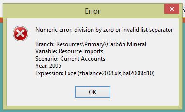

    Hi, I am trying to run the results but an error shows up, it indicates that a division by zero is ivalid but there are no zeros on the data base, can you help me find out what this error is about?
    Thank you.

    Hi Kelly,
    Is the number in Excel formatted in any way? For instance, if you are using a comma separator in Excel to write "4,000" instead of "4000", LEAP will give you the error you are seeing. I recommend changing any values linked to LEAP to the general format in Excel.
    Hopefully this helps!
