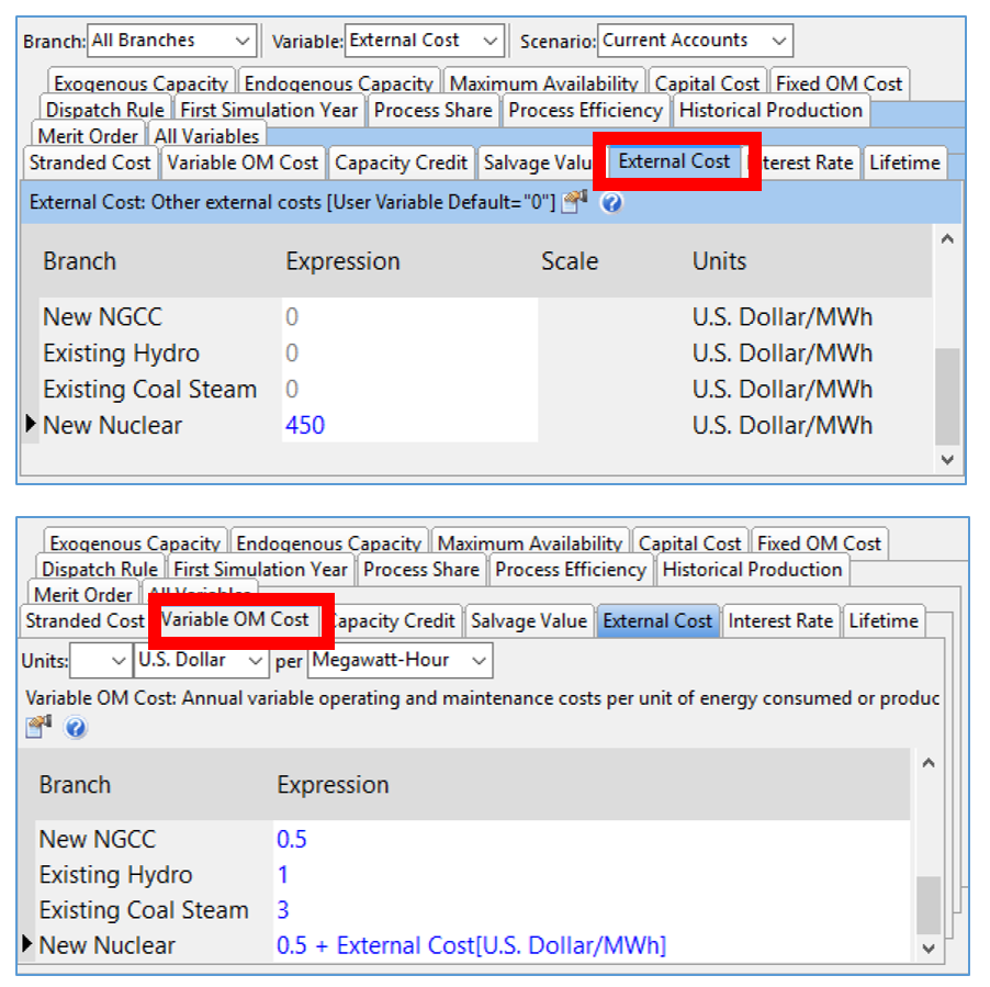

    With regards to question 1, as you may know, typically external costs, such as costs per tonne of CO2 emitted, are entered in the "Externality Cost" variable for the effects listed under the Effects branch. However, non-emissions related external costs should be merged with one of the default cost variables in LEAP in order to be included in LEAP's cost-benefit analysis. Since the external costs that you are considering are in the units of cost per MWh, it makes most sense to merge this with the Variable O&M cost variable.
    One way to do this is by creating a new user-variable for External Costs under the Transformation branches, and then referencing this new variable in the Variable O&M cost expression (see attached screenshot for an example). For help on adding new user variables, refer to the following help page: https://www.energycommunity.org/Help/Supporting_Screens/User_Variables.htm
