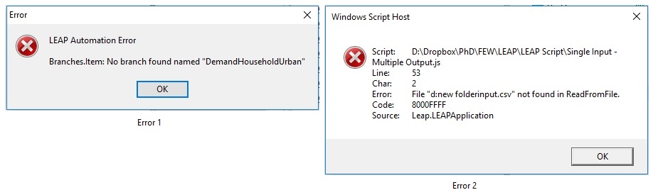

    • "ReadFromFile(D:\New Folder\Input.csv)"; //{your suggested format}
    Error = Branches,Item: No branch found named "DemandHouseholdUrban" {Error1 in Attachment.}

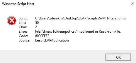

    Error = Files "d:new folderinput.csv" not found in ReadFromFile {Error2 in Attachment.}

    Regarding the error(s) that you've been seeing, without a complete working example I can only speculate. But I think they are being introduced by the interpreter, and not by LEAP or API. I am not very familiar with JScript myself, but do I think that backslashes will need to be escaped properly. Do you see your 'Error 2' for each one of the four ReadFromFile formats that you tried? To help debug, I'd suggest that before trying to pass the expression into LEAP through the API, first ensure that it is correctly being interpreted by JScript as a string.

    The following code is my JScript. Different formats that I tested are commented in the code. None of the works to assign ReadFromFile to Expression of a variable. (I see 'Error 2' for each one of the four ReadFromFile formats that you tried)

    I'm able to reproduce your problem by entering the ReadFromFile() function when typed directly into a LEAP expression, without using the API. So I think the problem lies in that function - we'll investigate it, and hopefully have a solution for an upcoming version of LEAP.
    In the meantime, can you accomplish what you want to do using the ReadFromExcel() function, to read from an MS Excel file?
