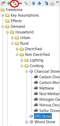

    Sorry for any confusion. The design of this part of LEAP has been changed in v2018. We no longer use the toolbar to the right of the screen in the Environmental Loadings tabs. We removed this because it was rather inconsistent with the standard approaches for adding and deleting branches in the tree.
    Instead we now use the standard add (green plus), and delete (red minus) buttons shown immediately above the main tree data structure in Analysis View.
    To add many pollutants from TED, first highlight a technology and then click the new green double plus button. See screenshot attached where that button is circled. You can also right click on a technology and select the same option from the pop up menu.
    We will get the training exercises updated in the near future to reflect this change.

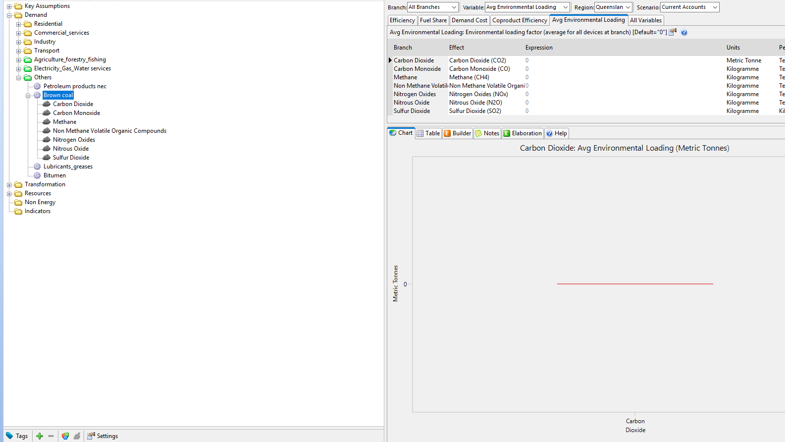

    I have added the environmental loadings as you directed to the technologies in the be=ranch, but the "Expression" for each "Effect" in the "Avg Environmental Loading" is zero for all the pollutant. I have attached a file showing the screenshot of a technology including the added environmental effect. I used the IPCC Tier 1 Default Emission factor but the expression were all zero. Please, can you give me some recommendation on it?

  • Emily Ghosh 12/10/2017
    Hi Nnaemeka,
    I was unable to reproduce the problem that you are having. Have you tried deleting the effects branches and re-adding the effects?
    Also, on a side note, you can always view the TED database in detail by selecting "Technology Database" from the Views menu on the left.

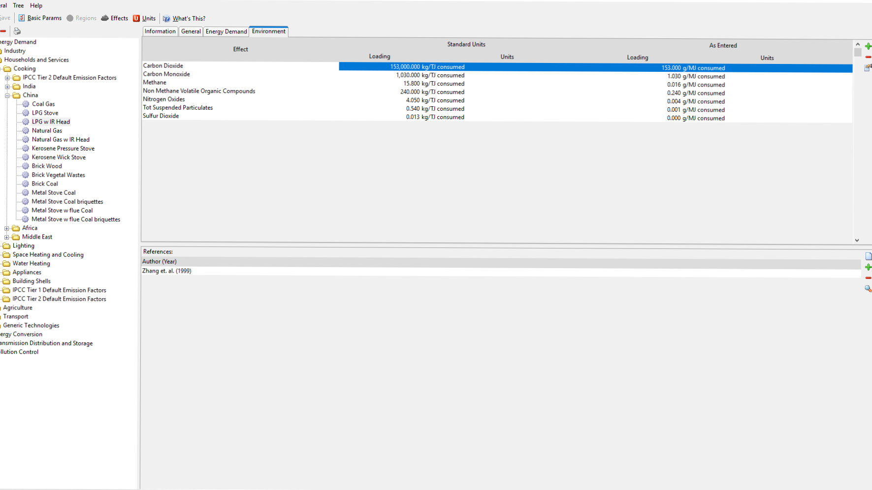

    I have tried adding the emissions factor from the TED database but the Expression is still zero. Although I've not added the reference scenario because am still working on the current account, do you think this might be the cause?
  • Taylor Binnington 12/13/2017
    Hi Nnaemeka,
    Neither Emily nor I are able to reproduce the problem you're seeing. Can you provide a comprehensive list of steps that you're taking to add the set of emission factors from TED? From looking at your two screenshots, it does not appear that you selected the "LPG w IR Head" branch from TED when you added emission factors into the Analysis view.

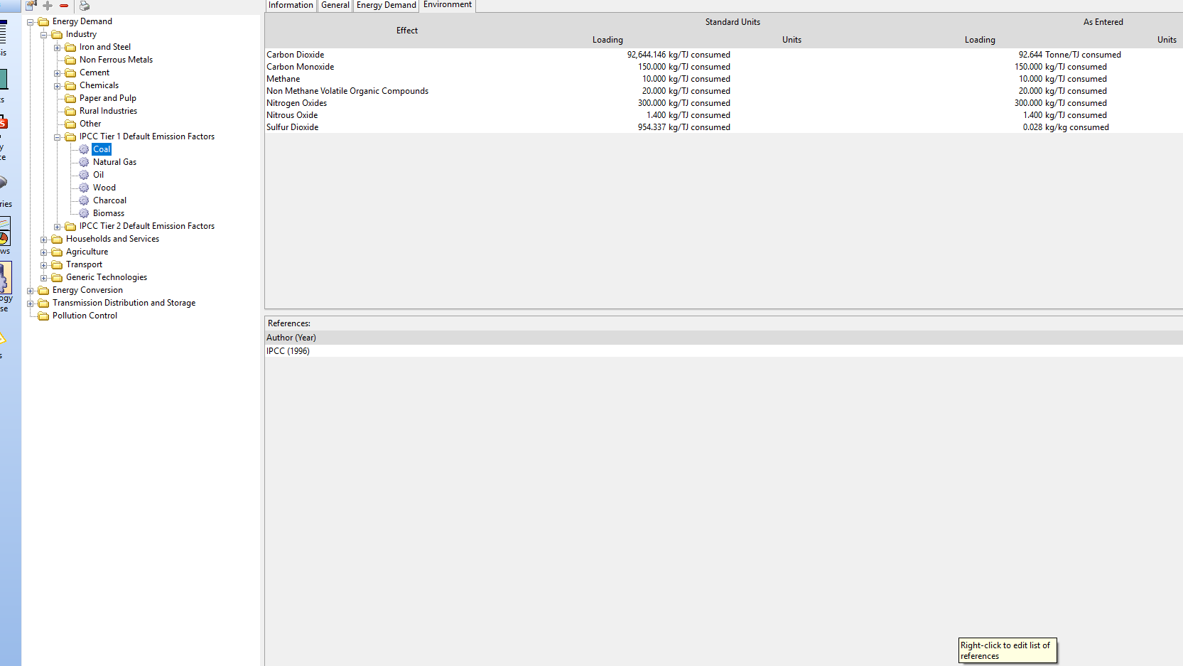

    Thank you for your email. After developing the branches and sub-branches in the current account, I selected the technology that I would like to add its emission effect (in my case, I wanted to add coal from the IPCC Tier 1 as shown below (LEAP 4) and after that, the expression was zero as shown in the screenshot (LEAP 3) attached below. Please, can you give me a suggestion on how to go about it?
  • Taylor Binnington 12/14/2017
    Hi -
    I still can't reproduce what you're seeing, but I'm also still not perfectly clear on the order of steps that you're taking.
    To add a group of emission factors from TED, do as follows:
    1. In Analysis view, select the branch in your tree under which you want to add emission factors.
    2. Click the ++ button above the tree to add a group of emissions from TED.
    3. Select the set of emission factors you wish to add from the dialog box which appears.
    4. Click Okay.
    What is the result you get when you perform these steps?
