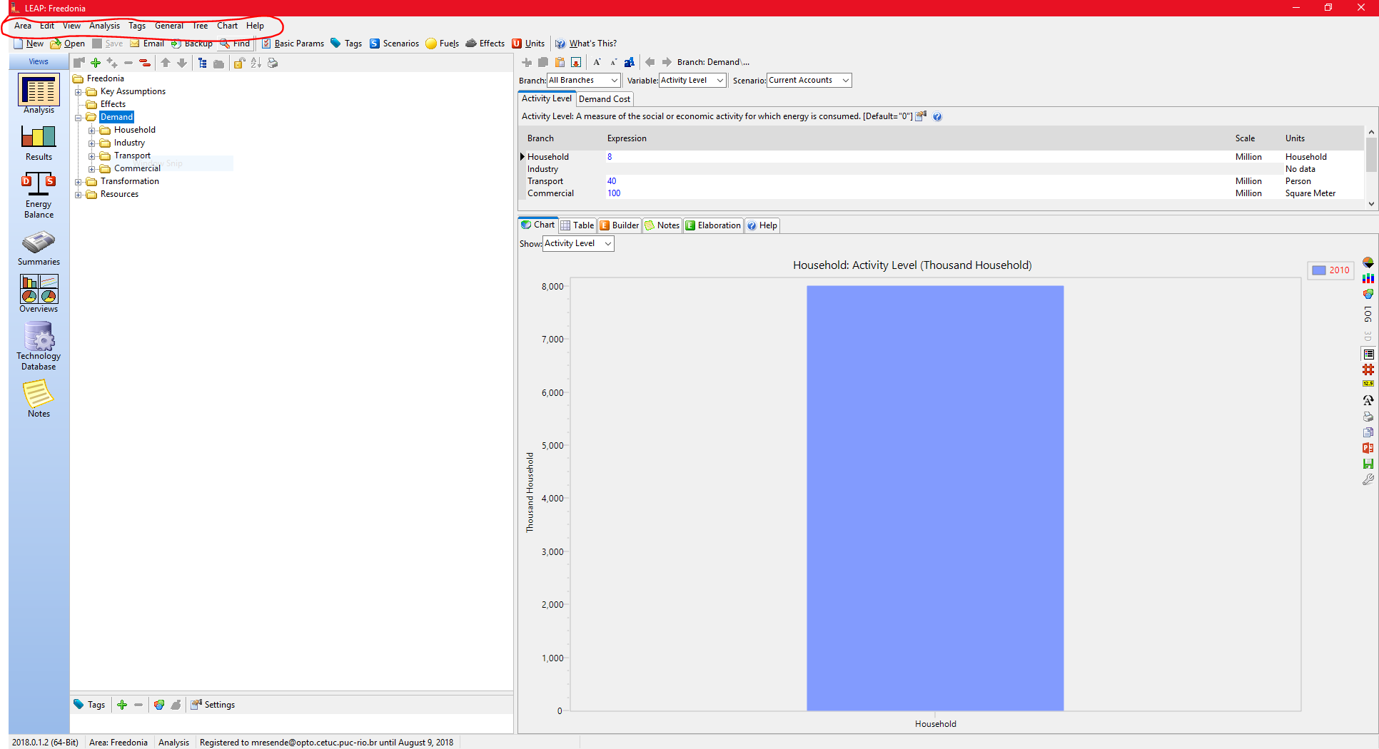

  • Marcelo Resende 12/19/2017
    Exactly, the "advanced" menu simply vanished from the analysis view, as shown in the image attached.

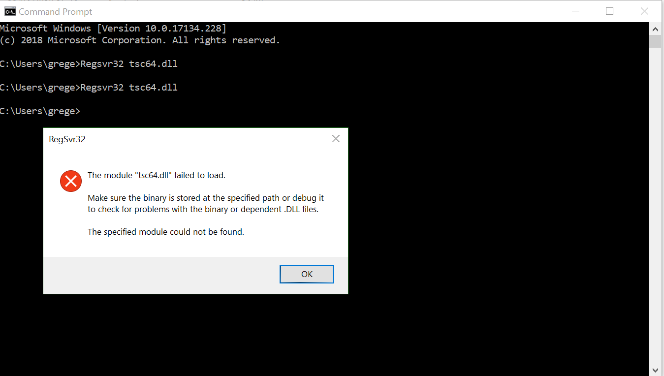

  • Gregers Larsen 8/28/2018
    I have the newest version of LEAP 64bit and I can still not get the "Advanced" menu to appear. The DLL file is in place in the LEAP directory, but seemingly not registered. Any method described in the cmd gives the attached error. I have Admin rights.
    I have even tried deleting and reinstalling LEAP, but no good. What could be going wrong?
  • Charlie Heaps 8/29/2018
    Hi Gregers,
    The command you are issuing is correct "regsvr32 tsc64.dll".  But I think regsvr32 is failing to find the file tsc64.dll.  I think that is because you are issuing the command while in the wrong folder.  Make sure you first change directory to the program files\leap folder (the folder where tsc64.dll is located).

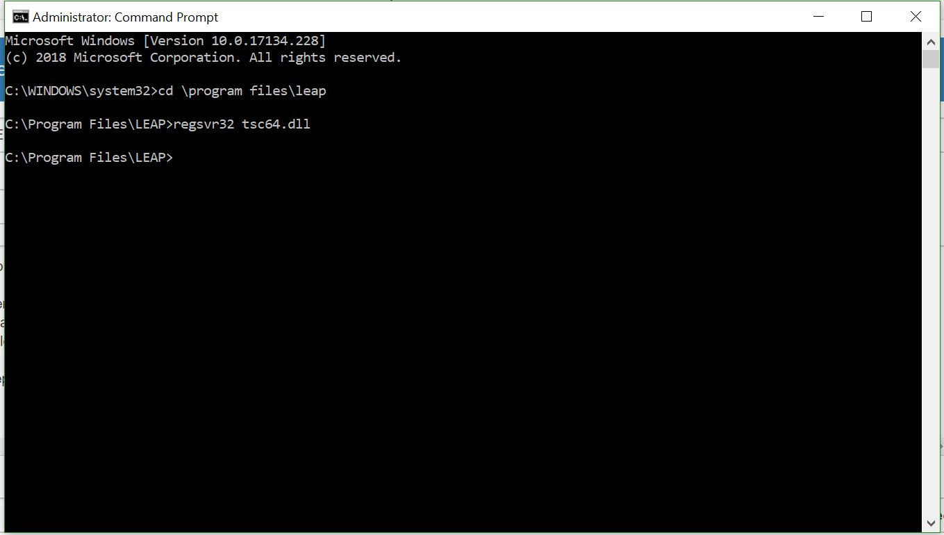

  • Gregers Larsen 8/30/2018
    I solved it! For anyone not familiar with Commando Prompt that has similar issues, here is what I did step-by-step:
    Prerequisites:
    * Have admin access on your PC
    * Close LEAP before beginning
    * Make sure LEAP is updated (then you'll already have the DLL file)
    * Find your LEAP install folder on your PC (usually \program files\leap\)
    Steps:
    1) Search "CMD" in your start menu. Commando Prompt should appear
    2) Right-click on the Commando Prompt results and choose "Run as Administrator"
    3) Commando Prompt will appear
    4) Write the following in CMD (no quotation marks): "cd \program files\leap" - If LEAP is installed in another folder, use that after cd - click enter after writing
    5) The directory should now show "C:\Program Files\LEAP\>" In that line write (no quotation marks): "regsvr32 tsc64.DLL". Press enter
    6) You should get a success pop-up
    When you now open LEAP 64-bit, the Advanced menu should be visible!
    Attached is a picture of my CMD line-by-line
    Gregers Larsen
