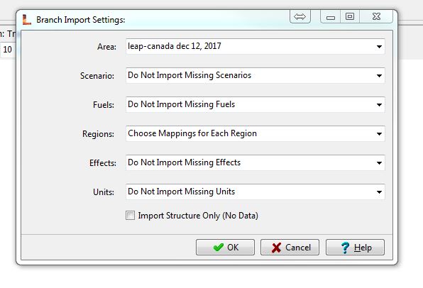

    2. Select the branch import settings as in the attached image 1.

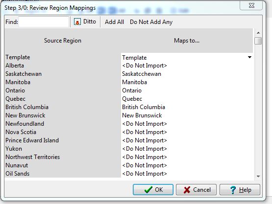

    4. Review the region mappings as in the attached image 3. I have to import only a few regions. So, I mapped only those regions which need to be inserted.

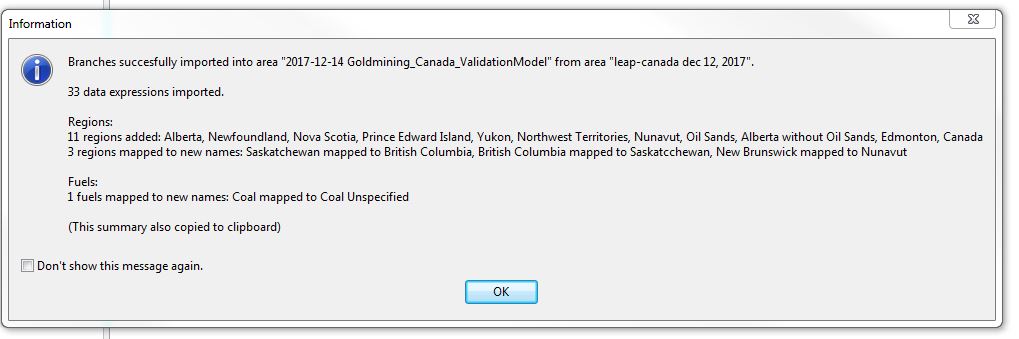

    5. Once I click continue, I get an information box showing the regions and fuels imported as in the attached image 4.
    It can be seen that I have selected not to import missing regions. But, all the regions are added to the area. Also, if you see image 4, 3 regions are mapped to new names: Saskatchewan mapped to British Columbia, British Columbia mapped to Saskatchewan, New Brunswick mapped to Nunavut. But, I have actually mapped corresponding regions (For example, British Columbia to British Columbia but not to Saskatchewan) as can be seen in image 3.
    Could you please tell me why all the regions are added and why the regions are not mapped one to one. Also, please tell me if this is the best way to insert branches from other areas. I have a master model and I have to import some branches from that into my other models. I feel that redoing everything in the models is time-consuming. It would be very helpful if you can help me out in sorting this.
