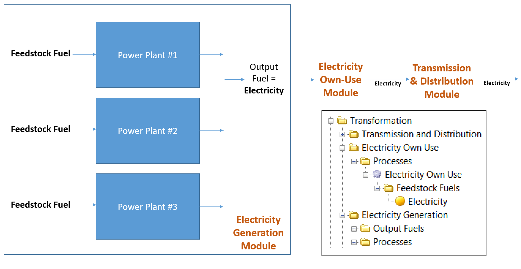

    To add capacity data, ensure that you have enabled capacity data to be entered for the Electricity Own Use module. To do this, right-click on the Electricity Own Use module branch, click on Properties, and check "Capacities". After you click OK, the capacity variable should be visible when you click on a process branch.
    Also, for your reference, the import target is for the output fuel and the feedstock fuels specified under a process branch represents the fuels consumed by a power plant. The power plant consumes as much fuel as needed to meet output fuel requirements; the amount of fuel consumed cannot be specified.
    On a side note, there is another way to model electricity end use that is simpler. Similar to the transmission and distribution module, electricity end use could be modeled as a loss rate, where the loss rate represents the total percentage of electricity generated by all of the power plants that is consumed by all of the power plants. To do this, create a new transformation module that is a "Simple non-dispatched module", add a process branch which uses electricity as the feedstock fuel, and enter the loss rate. Ensure the new Electricity Own Use module branch is placed above the Electricity Generation module - this way, the Electricity Own Use module consumes the electricity generated by the Electricity Generation module, which is already being optimized. Then apply a renewable target to the Electricity Generation module. (note that modeling the Electricity Own Use this way is just one of many ways - this is just a suggestion!)

    Thank you a lot for the clarification. I would like to go for a "simpler" option with "Non-dispatched" module, specifiying losses of electricity as you suggested. The thing is in my Transformation module I have "losses" (of electricity and natural gas) specified in the "Transmission and Distribution" module which is placed above "Electricity own use" (and "Electricity own use" is placed above "Electricity Generation"). I just wonder whether a new "Non-dispatched" module would not contradict "Transmission and Distribution" in terms of the losses?

    There should not be a contradiction because the losses in the two modules are for different things - one module is for electricity lost due to electricity own use, and the other module is for electricity lost from transmission and distribution.
