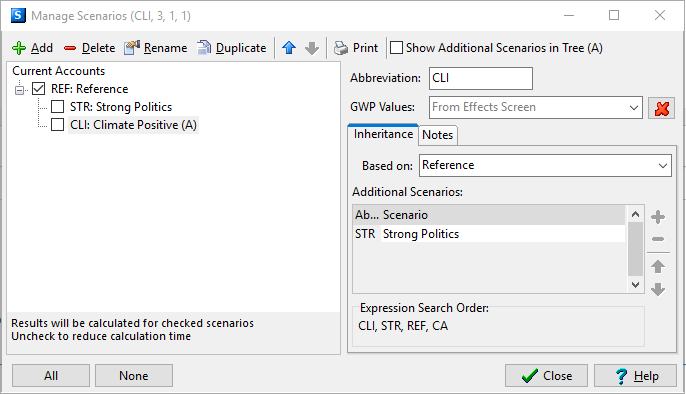

    There are a couple of ways of specifying scenario inheritance through the Manage Scenarios dialog box. The first way is to create a child scenario based on the main scenario (or parent scenario) that you are interesting in inheriting expressions from. To create this new scenario, first click on the parent scenario, and then click the green add button on the top. In the attached screenshot, the Reference scenario is a child scenario of Current Accounts, and Strong Politics and Climate Positive scenarios are child scenarios of Reference.
    The second way is to specify which sibling scenarios you want a scenario to inherit expressions from. To do this, select the scenario you are working on, click on the "Inheritance" tab on the right, and then click on the green plus button to add the additional scenario to inherit expressions from. If you look at the Inheritance tab in the attached screenshot, you will see that the Climate Positive scenario is based on the Reference scenario, and that it is also inheriting from the Strong Politics scenario. You will also see this in the expression search order listed at the bottom of the Inheritance tab.
