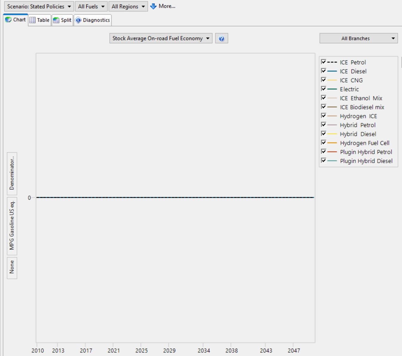

    I am conducting a new Transport analysis and I am trying to use past experiences to solve new questions. In this process I stumbled upon this possible error or mistake in my model.
    I have a full Transport Analysis stock turnover transport study, and it is working well. Except the results of New Vehicle Rated Fuel Economy and Stock Average Fuel Economy are both 0 for all years. All other results, such as Energy Consumption, Stock, and Mileage for the sector works just fine.
    What could be wrong? There is Fuel Economy for all the vehicles, since the Energy Consumption works.

    Hi Gregers,
    I was able to reproduce the problem with the fuel economy results in LEAP. Thanks for bringing it to our attention! I will let you know in a follow-up post once the issue is resolved.
    In the meantime, I suggest exporting the vehicle mileage and energy demand results to Excel to manually calculate the fuel economy.
