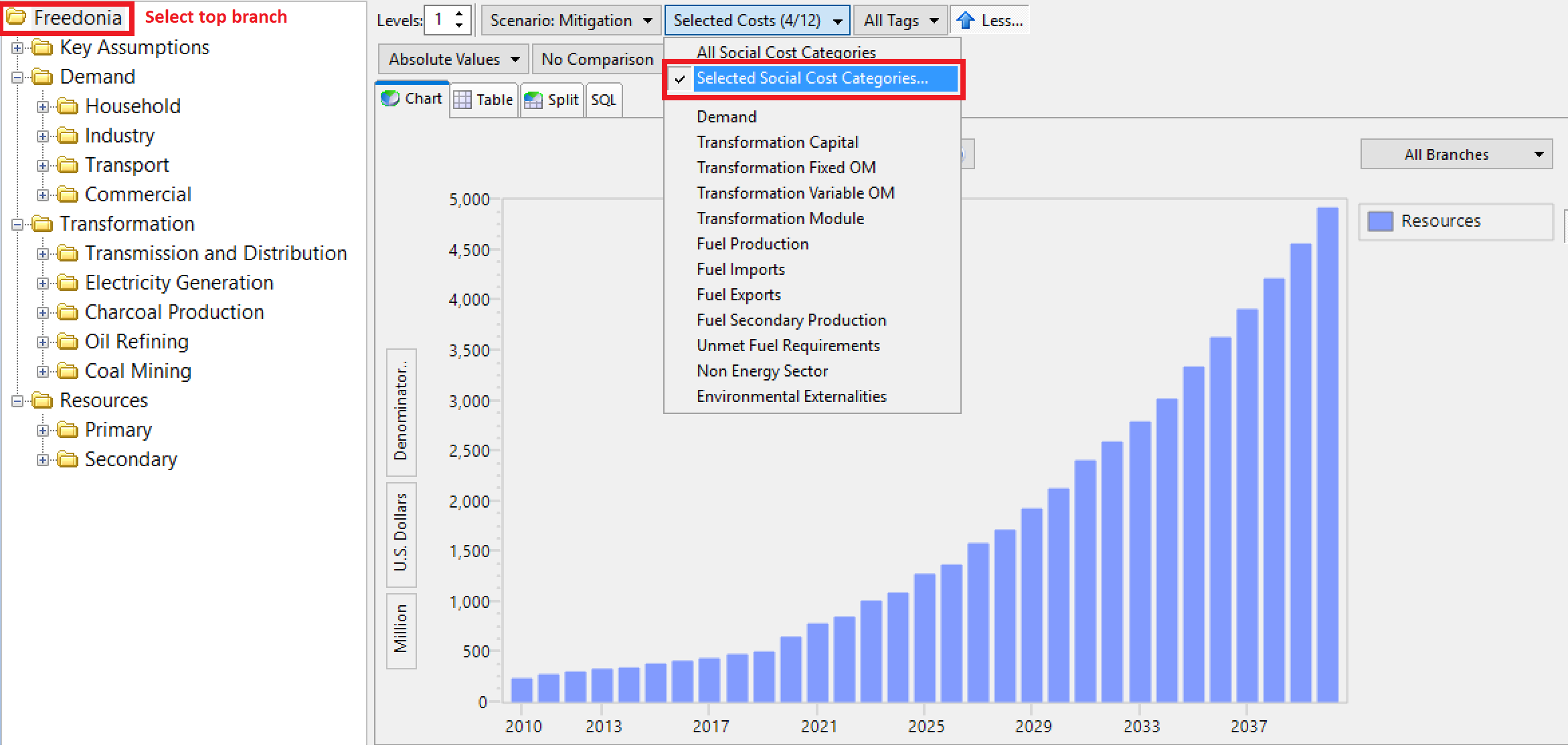

    In the "Social Costs" Results View, you can diagnose which branches are being considered in the fuel cost calculation. To see this result, ensure "All Branches" is selected in the legend drop-down, then go into the cost drop-down menu at the top (labeled "All Costs") and select to view only the Fuel cost categories. Then, ensure that the top branch is selected of your data set is selected. This will show all of the main branches which have fuel costs associated with it. I've attached a screenshot below which provides instructions in how to see this result.
    In general, the social costs consider the cost elements defined in the following help page: https://www.energycommunity.org/Help/Results_Categories/Costs.htm
    If you would like to change how the fuel cost calculation boundary is drawn, you can do so in the "Cost" tab under Basic Params. More information on the different costing boundaries is provided here: https://www.energycommunity.org/Help/Supporting_Screens/Basic_Parameters_Screen.htm#Costing_Methodology
